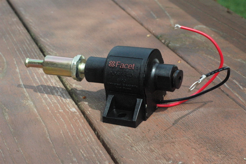

The new Facet is no long housed in a metal cube. NAPA says it has the same part number and specs: Facet Posi-Flo EFPE #60104 1.5 - 4 psi. I'll try to post a pic.
Looks like a vane pump now. Interesting. Let us know how it goes. And mounting it in the aforementioned rubber bobbins helps a LOT to reduce the feedback noise.
