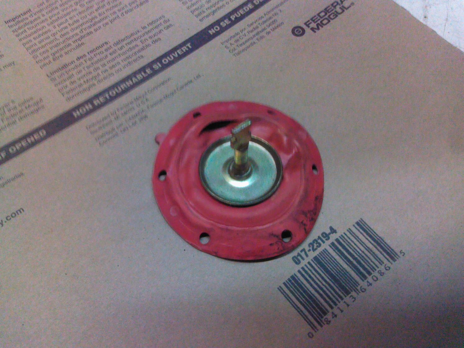

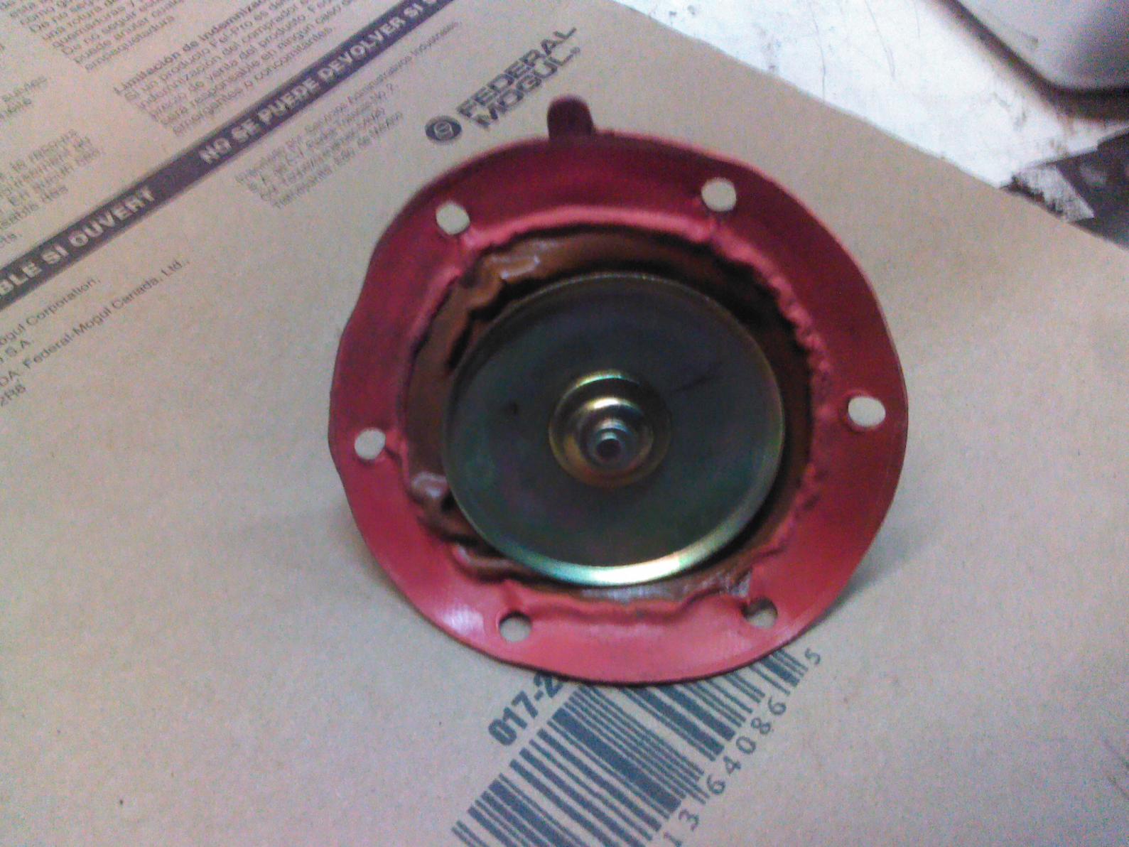

Just finished replacing my fuel pump diaphragm. Roughly 6 years and 20k miles.
It was advertised as being designed for modern fuels but I'm not convinced based on the look of it. Sure was easy to replace. 6 Screws and about 15 minutes.
Thoughts regarding the current ones being sold - will they hold up any better?

I had poor success but then I was told that you have to pre-stress the diaphragm when you install it. I think that means you need to push on the lever as you tighten down the screws. Otherwise the rubber gives up.
Jerry
Might depend on where you got it. I put in one from TRF back in the 90's and it was still working fine when my TR3A got wrecked in 2005 (or was it 06?) on the way home from work. Bought another one in 2008 and it is still working fine in my current TR3.
But for some odd reason, the TRF kits are much more expensive ...
Good info! I will loosen it up and pre-stress the diaphragm before I drive it.
Thanks.
It came from TRF back around 2005. Just bought another new one from them. Same color but different markings and outline. It will be interesting to see how it holds up.
