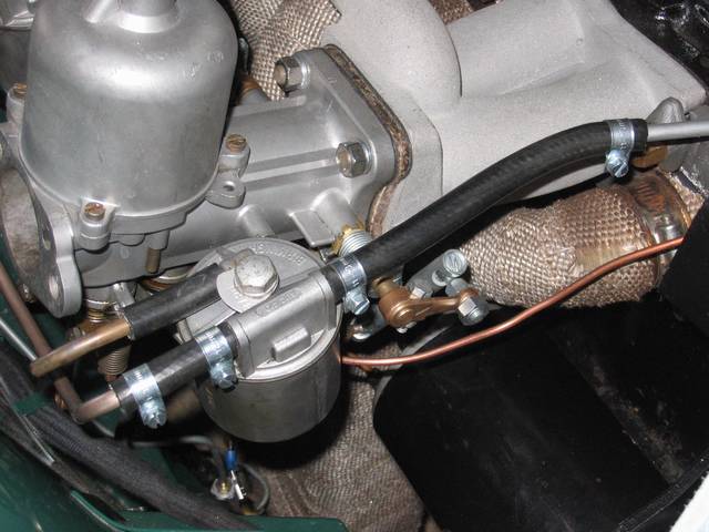

The TR3As after about TS-43000 came with slide-on black rubber hoses. They were never braided altough some use them now. For safety reasons TRA and VTR judges will allow you to put small hose clamps onto the ends of the hoses. I would slide off the old ones, cut new ones and put on small clamps.

Like Don I use clamps -- the fuel injection clamps (as he shows) are on one TR, I use spring-wire clamps on the other.
Dont much care for the cheese-grater band clamps because of the look, what they do to the hose and those ends can slice you when you're working under the bonnet.
"Horses for courses" of course. I actually prefer what Geo calls "cheese-grater" clamps, as I feel they are actually kinder to the hoses than the spring-wire ones (if you don't overtighten them), and adjust to suit a wide range of hose diameters. Plus if you are careful to get the fully stainless steel ones, they will last forever without rusting. Lots easier to remove and install with just my pocket knife, too.
YMMV and all that.

Randall,
In the picture that you posted above, what is inline sitting on top of the float bowl? Is that a fuel filter or something else?
Cheers,
M. Pied Lourd
Pied, the piece on top of the bowl is just part of the lid, for the later style float bowls (with push-on fittings).
There is also a short piece of bent hard line before the bowl, which I added to keep the soft line runs as short as possible with the bowl lid turned to clear the paper element air filter.
