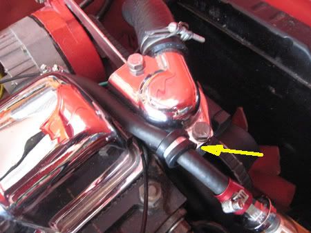

Here's a photo of how I routed my new fuel line.
