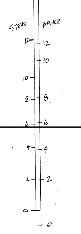

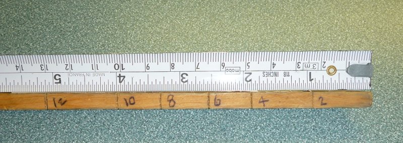

I goofed mine up while apart for cleaning. A couple of coils of the fine wire came off the cores and it started to get unraveled. I very carefully with fingers and a toothpick rewound the loose coils and then anchored them in place with super glue. When I put it back in the car it wasn't accurate at all. So I started adjusting the position of the coils in their slides. I got good registration but then as the fuel level changed the gauge became unreliable. I made a stick with markings to tell where the full level was and as I drove the car and used up the fuel in the tank I kept adjusting the gauge to reflect what the stick showed me. After about 4 or 5 adjustments thru 2 tanks of gas the gauge is now accurate. At least as accurate as it ever was. Dave.
88878971.oQJocxmW.jpgDIP-STICK the only true fuel measurement
View attachment 31378DIP-STICK the only true fuel measurement
FWIW - The main difference between Bruce's and mine is his goes into the well at the bottom and mine stays on the side.
Mine was made by adding water a 2 gallons at a time to a straight spare tank, leveled on sawhorses.
