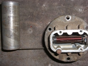

So I received some information back from Moss regarding their Bugeye p/n 361-880, fuel tank sender unit. They said since Winter 2011, this p/n has been improved and uses two sliders rather than just one. Since the one in my car NOW, was purchased from them in late 2008, it is the older design.
In the interest of advancing the breed, I decided to do some research and find out how these things work. I had an old sender unit that I replaced in 2008, so I thought I would take it apart. (THIS IS NOT THE SENDER IN MY CAR TALKED ABOUT ABOVE). This is the result: This sender # Smith FT5300/32 was used with fuel guage # FG 2530/31 at least in my car (1960). When the gas tank is full, the sender reading is about 80 ohms. When the gas tank is empty, the sender reading is about 0 ohms. Which means that the fuel gauge moves to the right as the resistance of the sender increases. So if the sender wire is grounded momentarily, (0 ohms) the gauge reads empty. If the sender wire is removed, the gauge reads full (high resistance). The sender terminal is at the right in this picture. The small wire connected to the terminal in the inside is connected to the coil at the left. Here the float is dropped and indicating an <span style="font-weight: bold">empty tank </span>(low resistance). Note the sliders moved to the left, using very few windings.

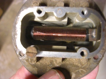

Now this picture shows the sliders to the right, which indicates a <span style="font-weight: bold">full tank </span>(high resistance). So what was wrong with this sender and why didn't I use it 4 years ago? All the wires are intact (I think). The sliders are making contact. The brass terminal is OK and the terminal wire is connected. Turns out the slider pivot is not making good contact with the body. If I connect the ground wire right to the float pivot, it works fine. If I connect the ground wire to the body of the sender (aluminum), it is sporatic. What I have discovered is that the Bugeye fuel gauge is just like the one in an MGA. Barney has all that covered in his MGA with attitude website. Cheers, and I apologize for all the tech stuff, but I am an engineer, and it is hard to get it out of my blood. Scott in CA

Barney's site is a wealth of information and a great go-to place for an in depth discussion of the early fuel gauge system.
Prior to 1964 the Mini used the same gauge system as the BE although the actual gauge and sender were physically configured differently. I experienced the same problem you reported with your sending unit above. There were corrosion and fuel deposits preventing the sending unit from getting a good ground path.
As long as the arm is still free to move, the liberal application of spray carb cleaner to the float arm's pivot point and aggressive manual working of the arm generally can dislodge the deposits and restore the sending unit to proper operation. However, you need to continually work the arm and flush the pivot with fresh carb cleaner frequently until you get a good clean assembly again.
I R a enge-neer as well and love this stuff!!
Kurt.
So I just tried Doug's solution to my problem, and IT WORKED!
I also placed a dimple with a center punch on the outside of the body at the pivot. Good enough I think to stand the pain of removing the tank, again!
Thanks Doug!
Scott in CA
Thanks Doug. That was the magical piece of information that just didn't seem to exist anywhere.
