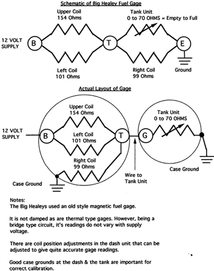

To my knowledge, the "Big Healeys" always used the magnetic fuel gage. The BJ8's were slightly different. The gage's one redeeming feature was that it did not require a voltage stabilizer to compensate for varying supply voltages. Maybe the attached schematic will explain some of the strange workings of the gage. The coils in the dash unit are adjustable for position-magnetic gap so they can actually be made to be fairly accurate with enough adjusting. See attached.

Thanks for the schematic Dave, it's a very good illustration. I'm already familiar with that family of instruments.
I only suggested this as a possibility as the description was for a reverse acting gauge. However, if big Healeys never had the voltage stabilizer then there should only be one type of sending unit. I hope my previous post didn't confuse the situation... I tried to offer it with a caveat.
