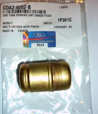

With that said, it is an easy fix for your fuel sender; I replaced mine with a brass one and all is good.

The Ford float is a good replacement and snaps right into the float arm. However, before you put the new float on, look carefully at the formed end of the float arm and remove any sharp burrs left on the cut end of the steel rod. The first time I used the Ford float I didn't check this and a sharp burr cut through that nice new brass. Fortunately you can solder that sort of damage back closed!
