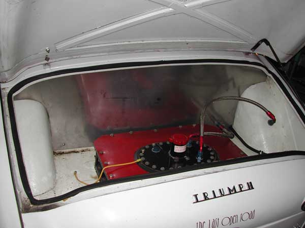

Greg, the PPO of my old TR3 racecar (I guess I'm the PO now) made a 12 gallon ATL Saver Cell. He used galvanized steel for some reason (maybe it was free?) which is O.K. except that it looked like a garbage can, so I painted it red, the color for fuel according to the FAA.
He cut a hole in the trunk floor so the cell sits down in the spare tire compartment. But it still rises above the trunk floor. See attached photo.
I ran a vent hose up and then down to the wheel arch to an AN bulkhead fitting. I made a panel out of aircraft stainless steel firewall material in place of the stock fibreboard piece that covers the stock tank. I put the pump and filter on the forward side of this firwall (where the stock tank would be) and used AN bulkhead fittings to pass through the stainless.

I cut a rectangular hole in the floor of my Spridget. My cell is halfway above the floor and halfway below. I used 2" aluminum channel framing around this hole to strengthen it. My battery is to the right of the fuel cell and under the trunk floor (the red battery wire in the picture leads to it). The blue fuel line nearest the red battery wire goes to the Facet fuel pump (mounted next to the battery). The blue fuel line going off to the left leads to a vent.
I've put an 1/16" aluminum firewall in place of the cardboard panel that normally seperates the trunk from the passenger compartment. My master kill switch is in the top of the right rear fender (to keep the unswitched "hot" cable as short as possible). The heavy black cable comes out of the kill switch and goes forward to the engine compartment.
