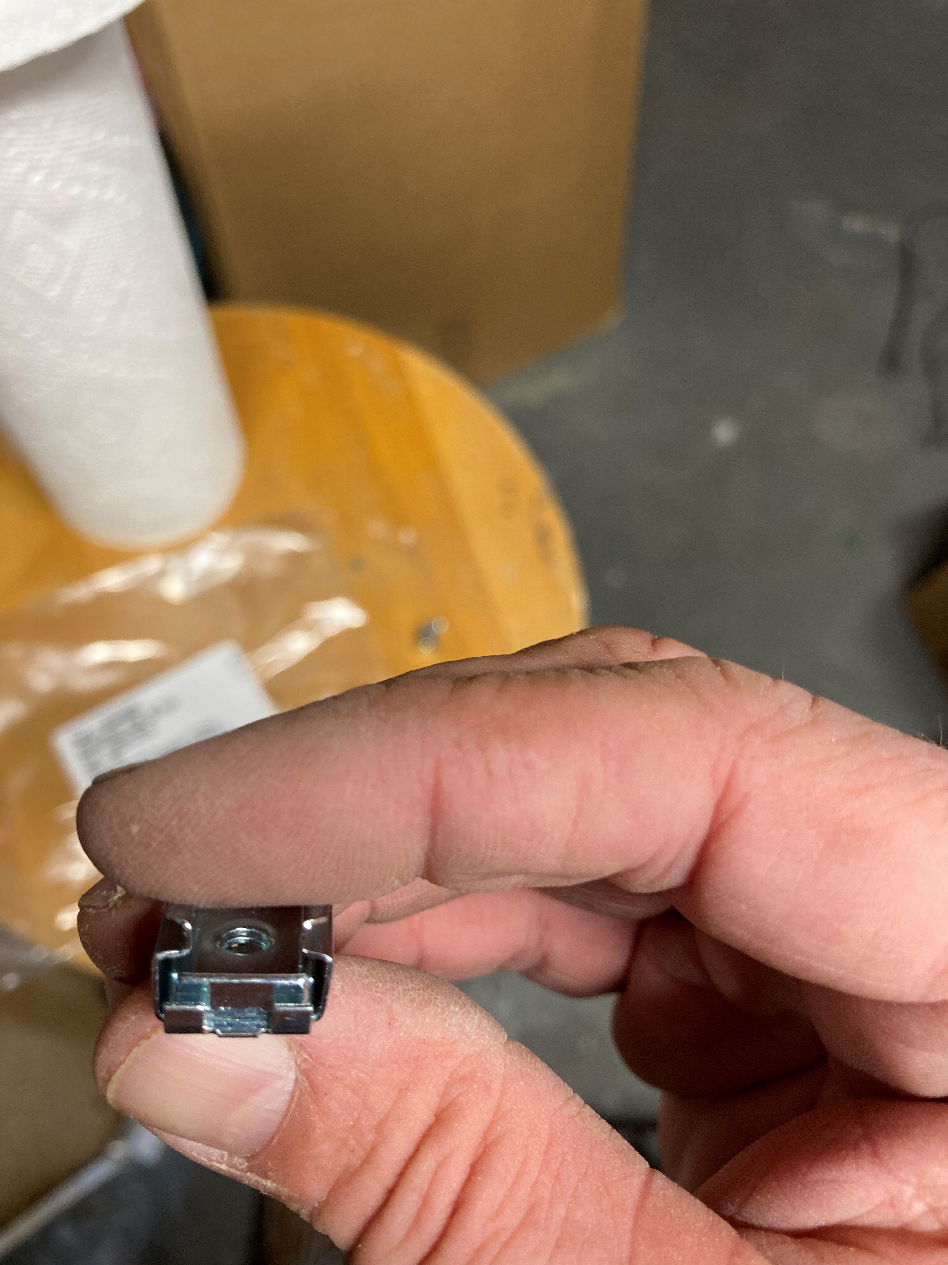

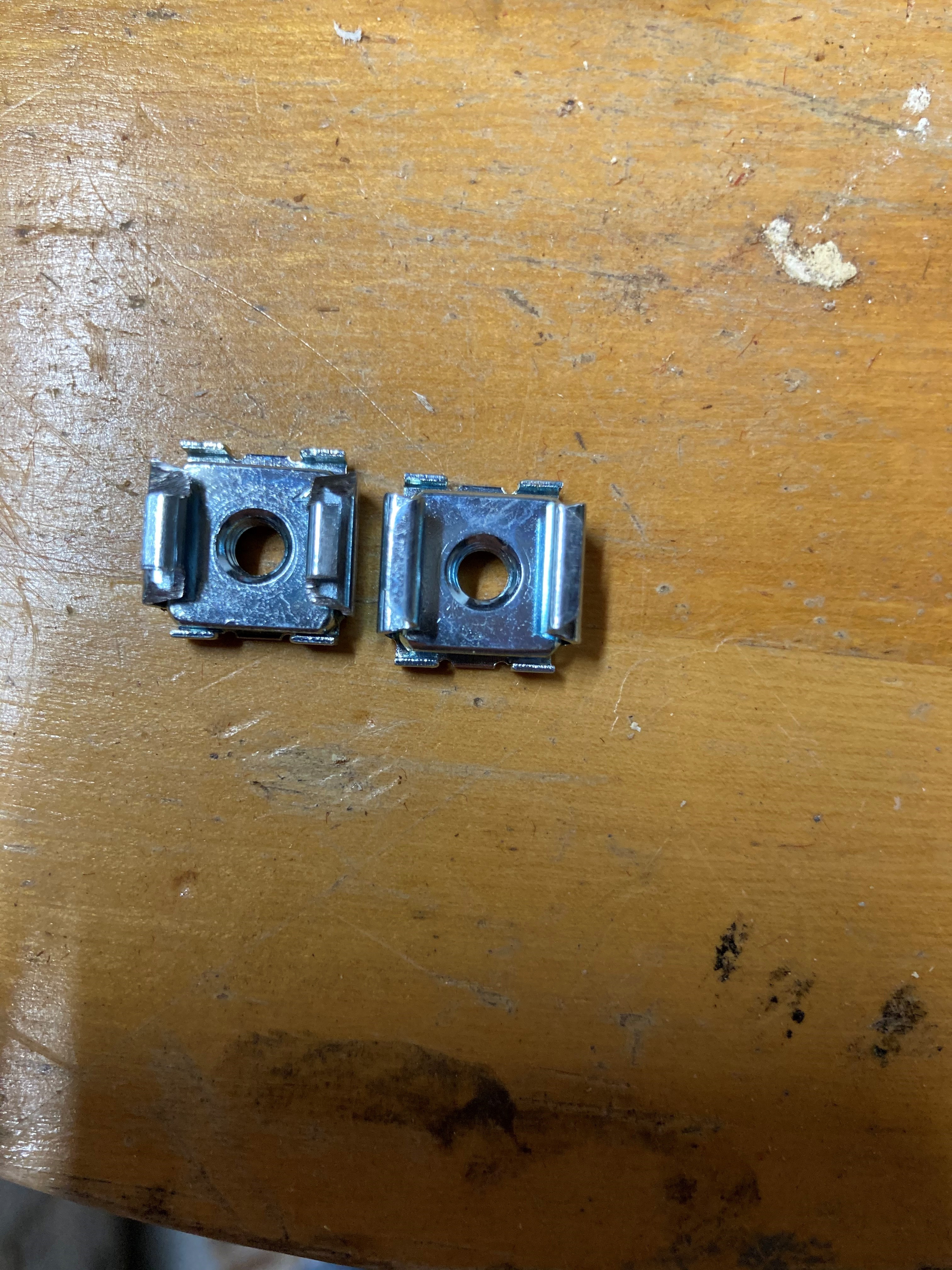

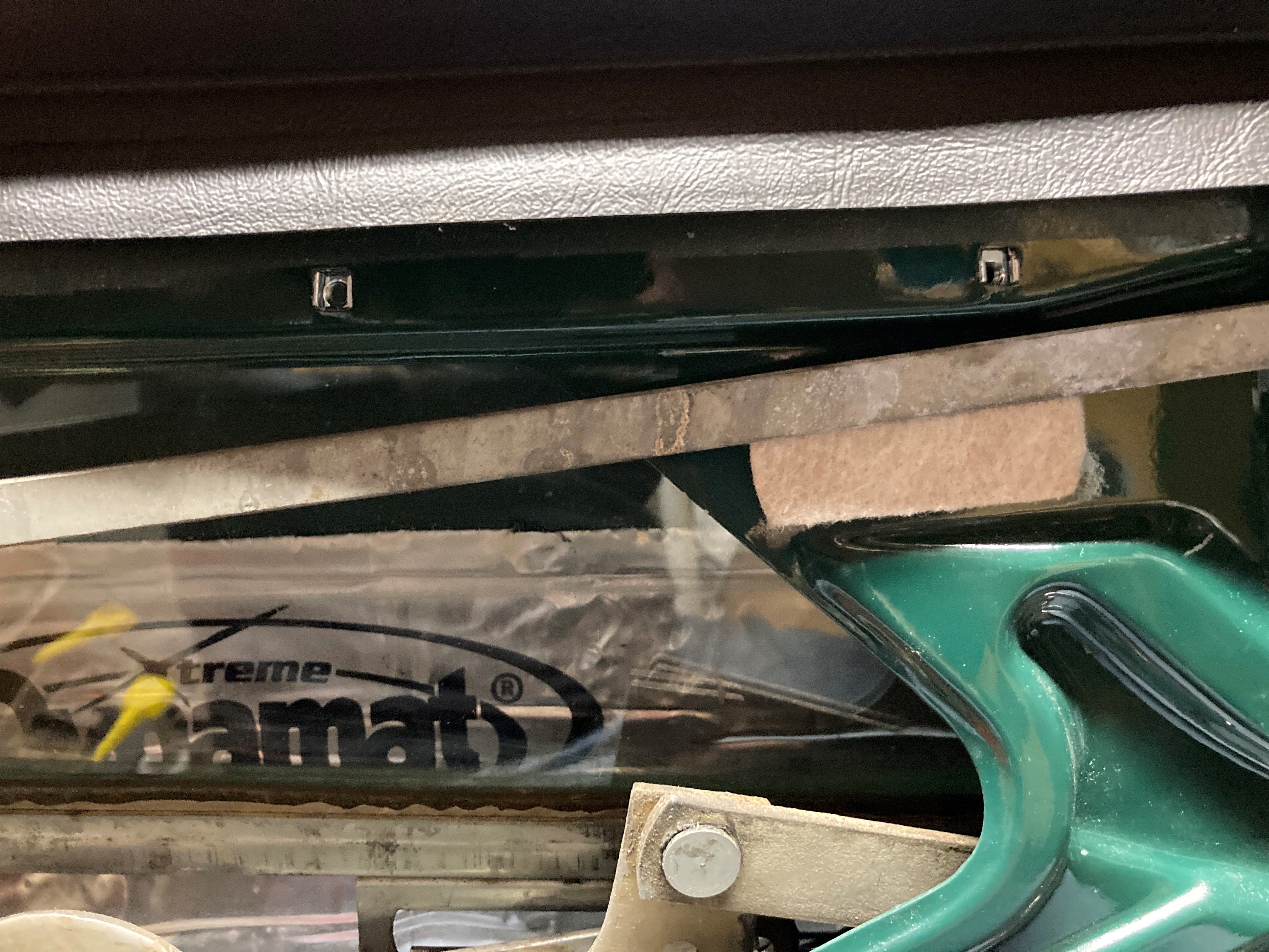

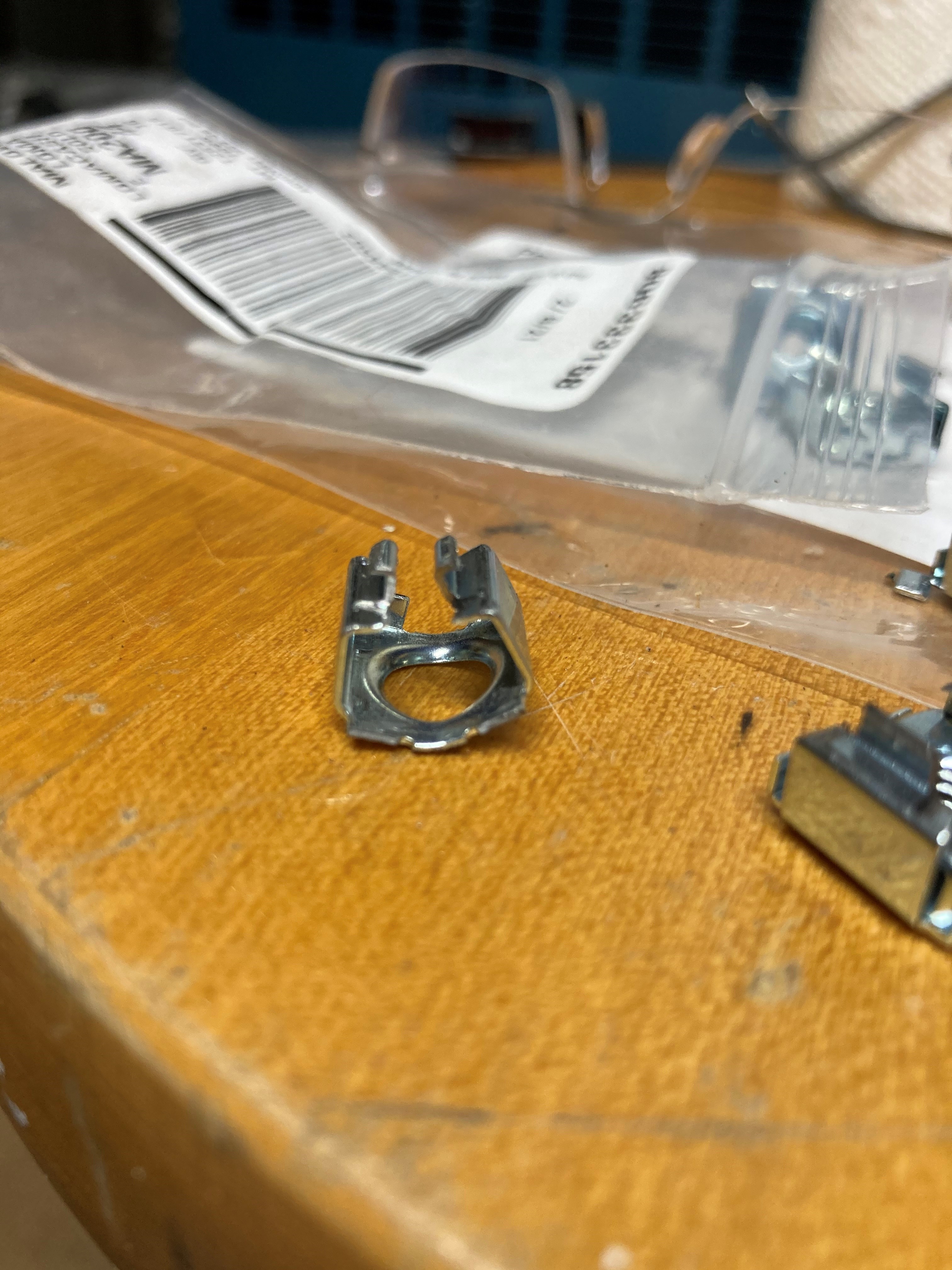

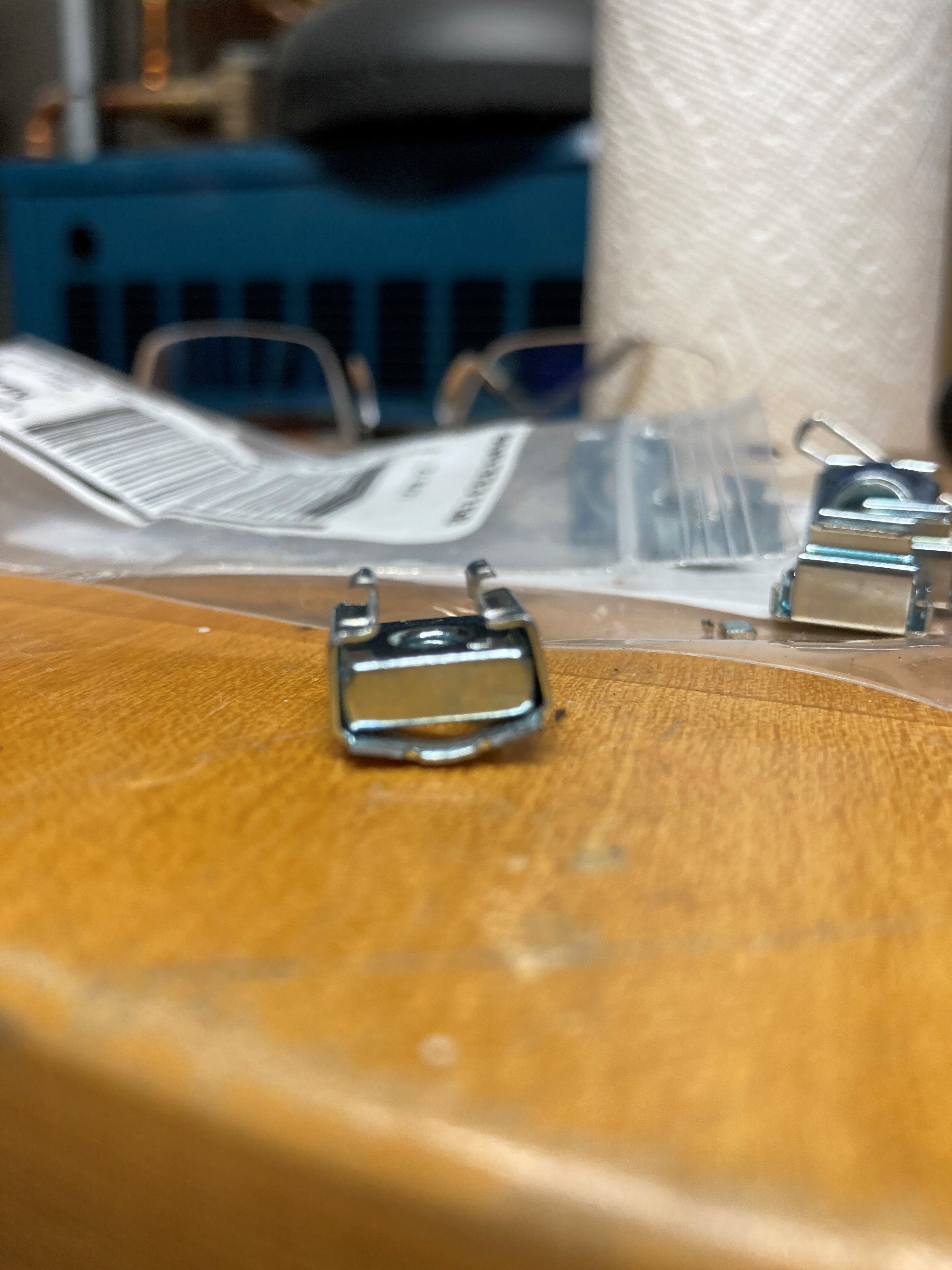

I found a similar cage nut at Fastenal, part number 11544402. These are a bit too large for the square holes in the Triumph door; too wide and too tall. I did not want to alter the Triumph sheet metal, so I modified the Fastenal cage nuts. Photos attached show, (1) the cage nut as received from Fastenal; (2) trimmed down in one direction; (3, 4) final trim - plus bend to get the "ears" closer together, and (5) nuts in place in the door.
When trimming the ears, I used a file to create an angle, so the caged nuts snap in easier, somewhat visible in the third photo. I removed the nut from the cage (by removing the tabs holding it in place), which allowed me to put a crease in the cage (photo 3) to get the ears close together. Working the nut back into the cage took some doing - fingers too fat, etc! "Snapping" the final assembly into the door is also a bit awkward - I did things out of order and already had the glass and window scrapers in place.
