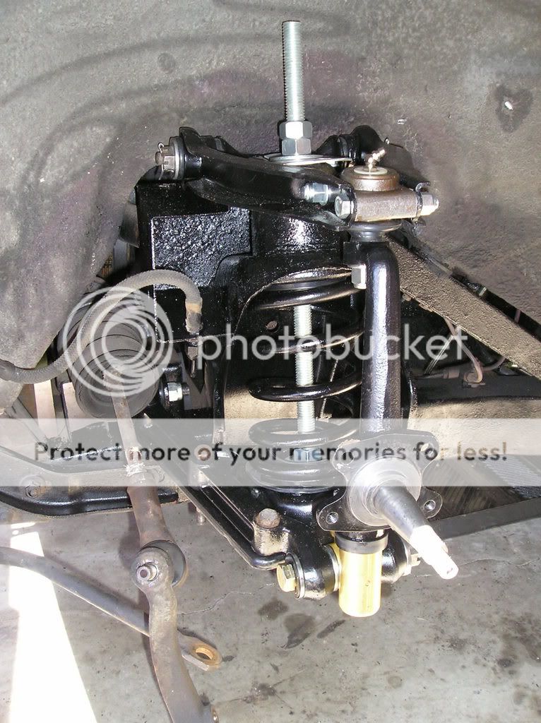

I'm in the final throes of reassembling my front suspension. As Bill says, it's pretty straightforward. My goal was to replace all the bushings to improve the ride. Since my tires haven't fallen off in 25K miles, I figured I didn't need to worry too much about that...yet. In the moss diagram the wheel hub fits over the stub axle (No. 50) which is fastened through the vertical link (No. 20). There's a castellated or nyloc nut on the back side that holds the stub axle into the vertical link, but I did not remove the stub axle from the link to know exactly how it goes together. Here's a semi-reassembled picture:
I have found this to be a fun and satisfying project, although I'm very ready to have it back together.

John, fantastic photo to help me figure things out.
Your photo also caught me eye in that I probably should
replace the steering mechanism. DPO Pedro specifically
mentioned the steering was in good condition but might
need a "little work". That tells me it's totally shot,
dangerous to drive and held together with Elmer's glue
and K-mart brand duct tape.
