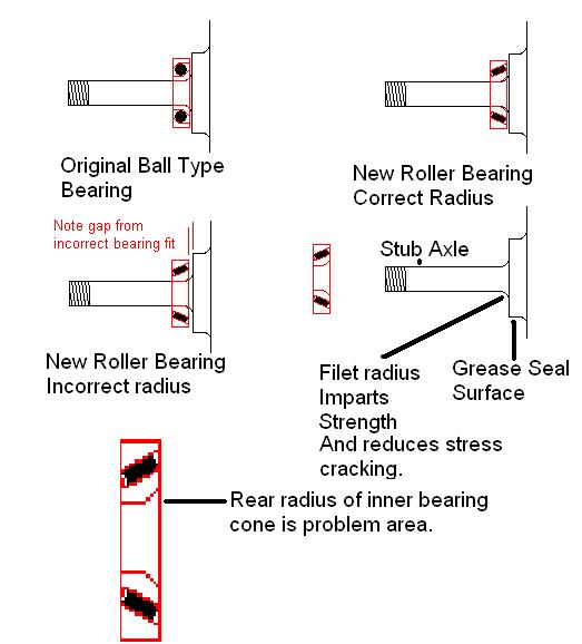

Most of the replacement ball bearings are not exactly correct. So many people use the roller bearings. However, you need to be careful since there is a radius on the spindle that can cause the hub to sit out too far. I hate to say it, but ask Peter. He probably has them in stock. You may get lucky with replacement ball bearing and they will work, but often the spacer needs machining by a few thousands (or worse ... needs lengthening)
The guys at the Winners Circle in Cleveland, (216-889-4666), know all about this question. I bought a Tapered Roller Bearing Kit from them last year, but havnt put it in yet. They give good reasons for switiching to the tapered bearings, and will give you the tips for placing them properly. THERE WEB SITE IS SPRIDGET.COM.
Trevor Jessie is right on, Peter does have the correct bearings to fit and at a good price. The problem on many bearings is as he said, not enough chamfer on the ID to clear the filet radius on the spindle. I highly recommend checking the fit of any bearing before installing it in the hub or packing with grease. All you have to do is slide the inner bearing on the spindle and check if it fits flush or nearly so up against the rear of the spindle. If not the radius is wrong and you need to either get another bearing or if no other bearing is available increase the radius of the bearing. I used a die grinder with a small stone and then washed the bearing carefully and packed with grease.

I ordered the first set of bearings before I went to see Peter for the shocks. After an "I told you so", Peter told me that he has good quality ball bearings available. But I am just not comfortable with ball bearings for the front hubs and opted to go with the taper bearings anyway.
I know, these cars have done well over the years with ball bearings. It is just my comfort level after more than 50 years of maintaining and repairing vehicles and machinery and replacing thousands of bearings I will feel better knowing that there are taper bearings in there. Please remember that it is just my opinion.
