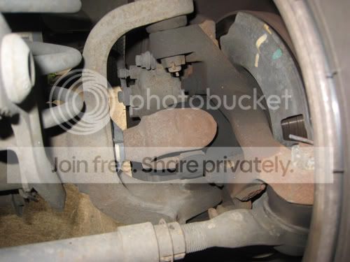

Here's a photo of my boulder bouncer Jeep front suspension.
The beast lives outdoors, takes regular swims in the ocean,
drags a boat hither and yon. All maintenance by the book and
by the dealer. It appears I have an oil leak of some kind.
But the assembly looks sound and safe. I have full confidence
in this vehicle.

You don't have to replace anything up there for that surface rust. If you did, every car on that island would be on jack stands every month.
DRIVE IT!!!!!!
:iagree:
Surface rust I wouldn`t worry about too much. In the atmosphere you live in it is inevitably going to do some rusting no matter what you do other than have every part made out of stainless steel. And that not practicle. I say drive it till the wheels fall off then rebuild and drive it some more. As far as the jeep goes My best guess is that the inner wheelbearing seal is in need of some attention. Quite common actually on 4x4 vehicles. The hub is a little tricky to dis-assembel and re-assemble, you`ll need a special socket to get the wheelbearing nut/s off and some snap ring pliers to remove the intergal gears in there {inside of the hub} Not really technicaly difficult just pay attention to how it comes apart, make your notes, take pics of the dismantling proceedures. You can accomplish it no doubt.

As for your surface rust, I wouldn't bother tearing it down to fix it, since it's really only affecting appearance.
And for the Jeep... that could be (assuming it's a Cherokee) fluid from the leak prone winshield wiper bottle located on the inside of the front fender. Mine leaks.
As for the hubs on the TJ and XJ, they are sealed units, and I've always just replaced them as a whole unit. Once the axle shaft is out, there's three bolts that hold the hub to the spindle (or hub carrier, I guess). As I recall, the nut is a 36MM.

I'm with them! Don't re-rebuild a 6 mo. old suspension job just because you got some salt-air patina on it.
Wait for something actually bad to happen. It probably won't be that long...

Are you getting a little case of Shipwrights down there in that freezing cold 72 degree weather??? Whatever you replace will be rusty in three more months, so why bother?
Do the differential and drive the car.

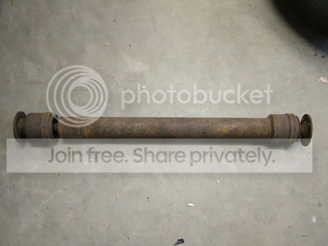

Hey dale, If your collecting driveshafts I got one for a TR8
Peter, you are right. Black oxide gives no protection to the elements. The color of zinc doesn't matter. Some manufacturers coat with gold just to help differentiate Grade 8 from the others. All of the Grade 8 zinc coated fasteners I sell are silver.
Tinster, the red grease will stop the rust for a while. It will also serve as a magnet for road grime. Eventually, it will probably wash away or wear away from normal driving.
I agree with everyone else about the rust. The most important part of that connection is the thread to thread where you can't see. After 6 months, it is probably looking like new.
