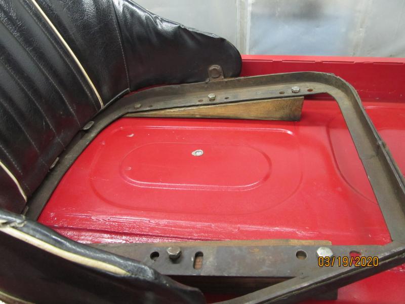

I did what John did only to a much greater degree. I cut wooden wedges and removed the sliders so the seat is bolted directly to the floor.
Mine is a roadster, the convertibles might be more restrictive as far as clearance for leaning the seat back.
I don't need adjustability since no one but me drives it and removing the sliders keeps the seat as low as possible.
I tried the raised seat pivot point years ago but IMO, raising the front of the seat cushion makes it more like reclining in an easy chair and vastly improves the comfort because my thighs carry some of the load.

I would guess the simplest method would be to cut tapered wooden supports to replace the existing flat ones between seat bottom and the floor ???

My BJ7 seatback seems too upright for my comfort, with the wheel too close and lacking lumbar support (I'm 6') I might give the washers under the front of the seat a shot. Wonder why whey put the wooden spacers under the seat, was it to boost up the height for shorter drivers to see over the bonnet? Big Healeys have wooden spacers on both seats where both seats are adjustable. Bugeyes, OTOH, only have a spacer on the driver's side as the passenger seat is not adjustable and is bolted down via metal brackets.
Yes the wooden spacers are to clear the carpet U can include their thickness in the tapered spacer or put the spacer of less height on top OK
Plus:
In my case i do not like the soft wood the original spacers were made out of , so even if I duplicate them I use OAK which when added a coat of varnish look origanlish.

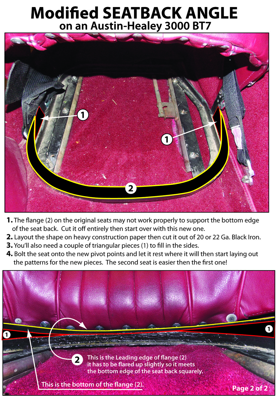

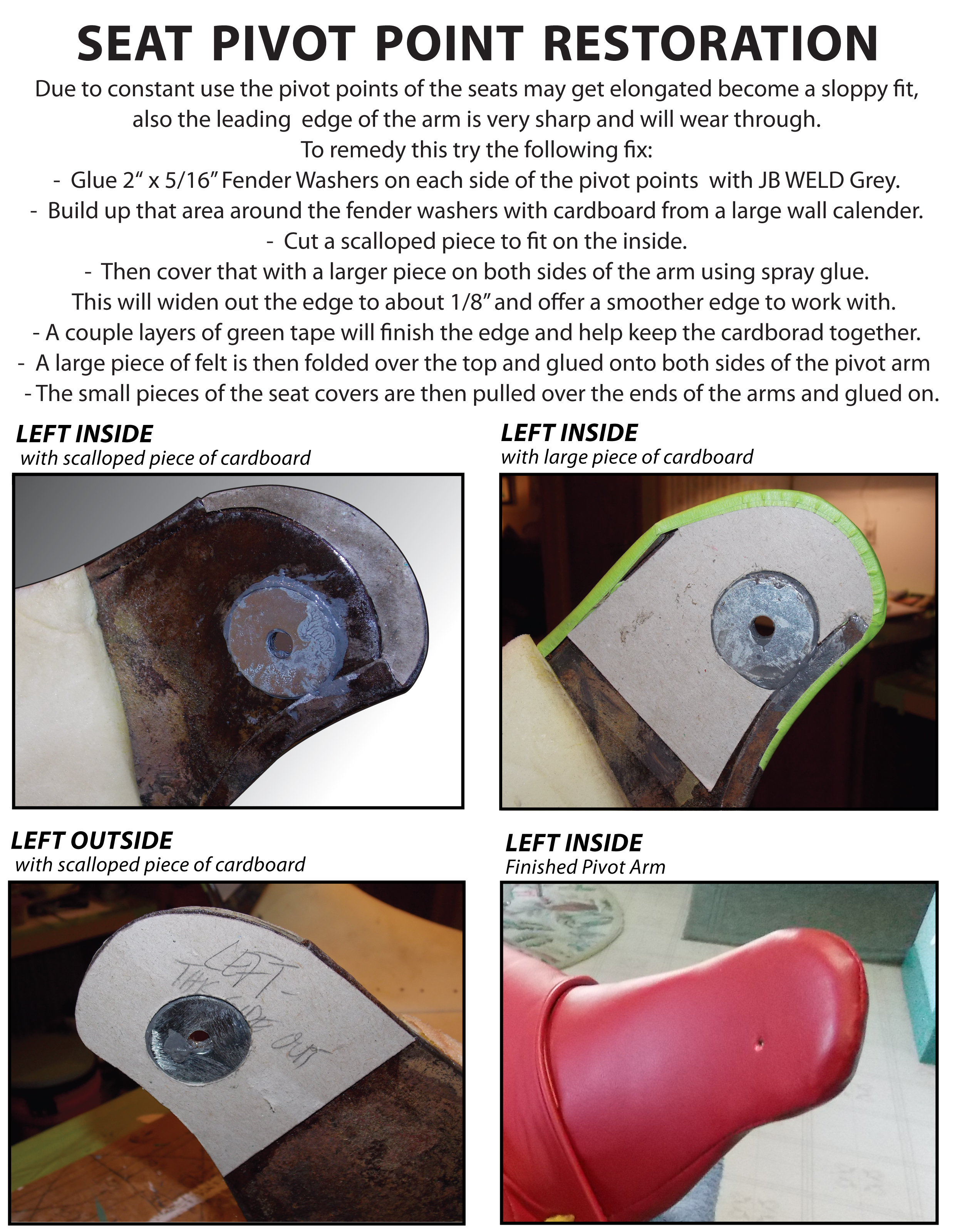

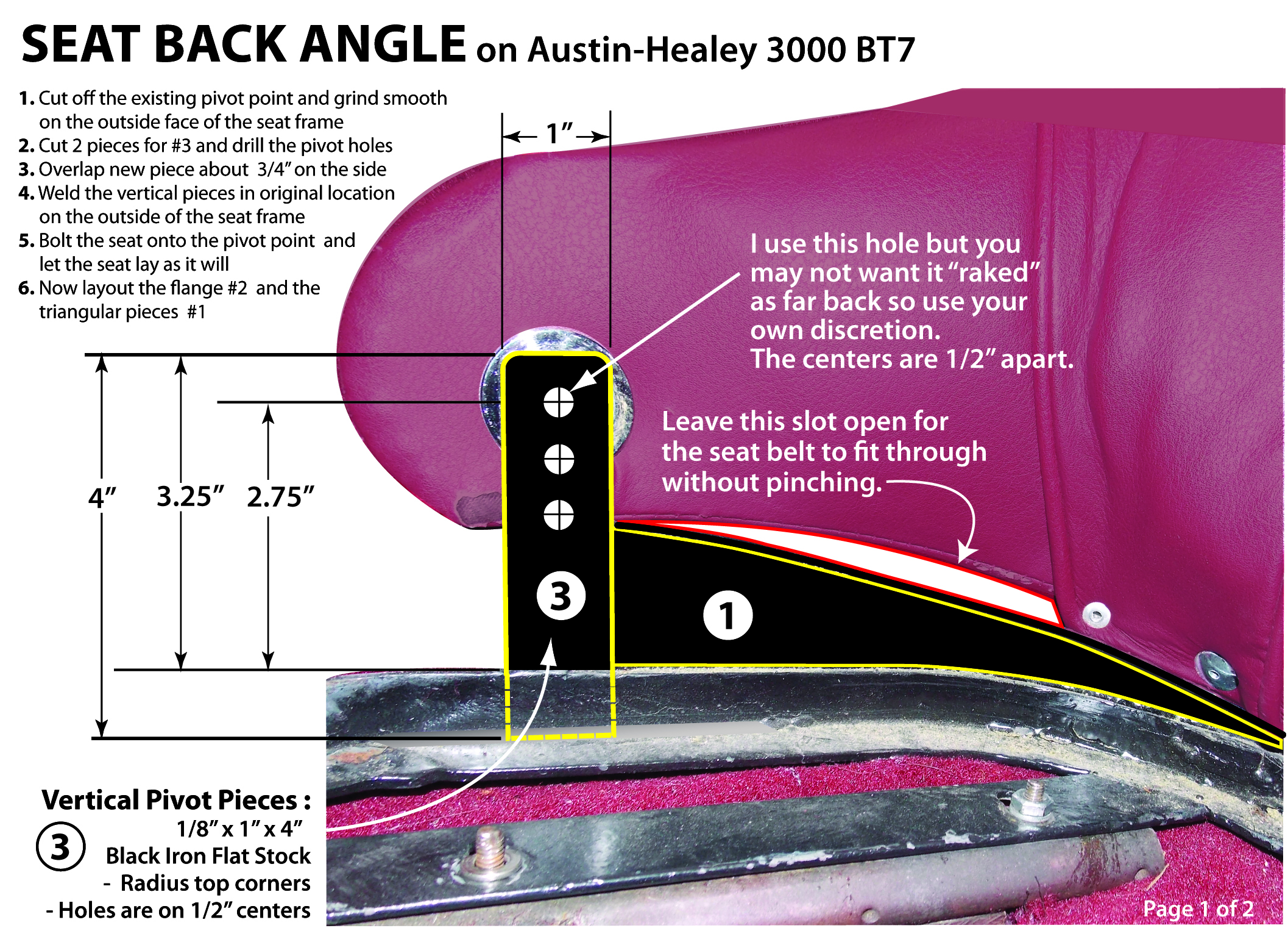

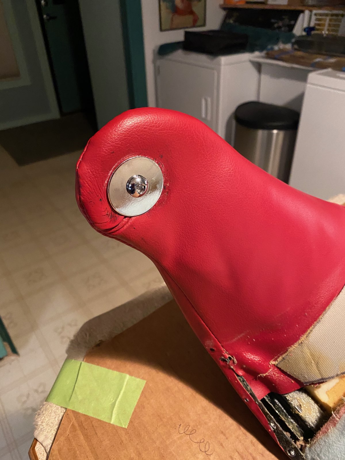

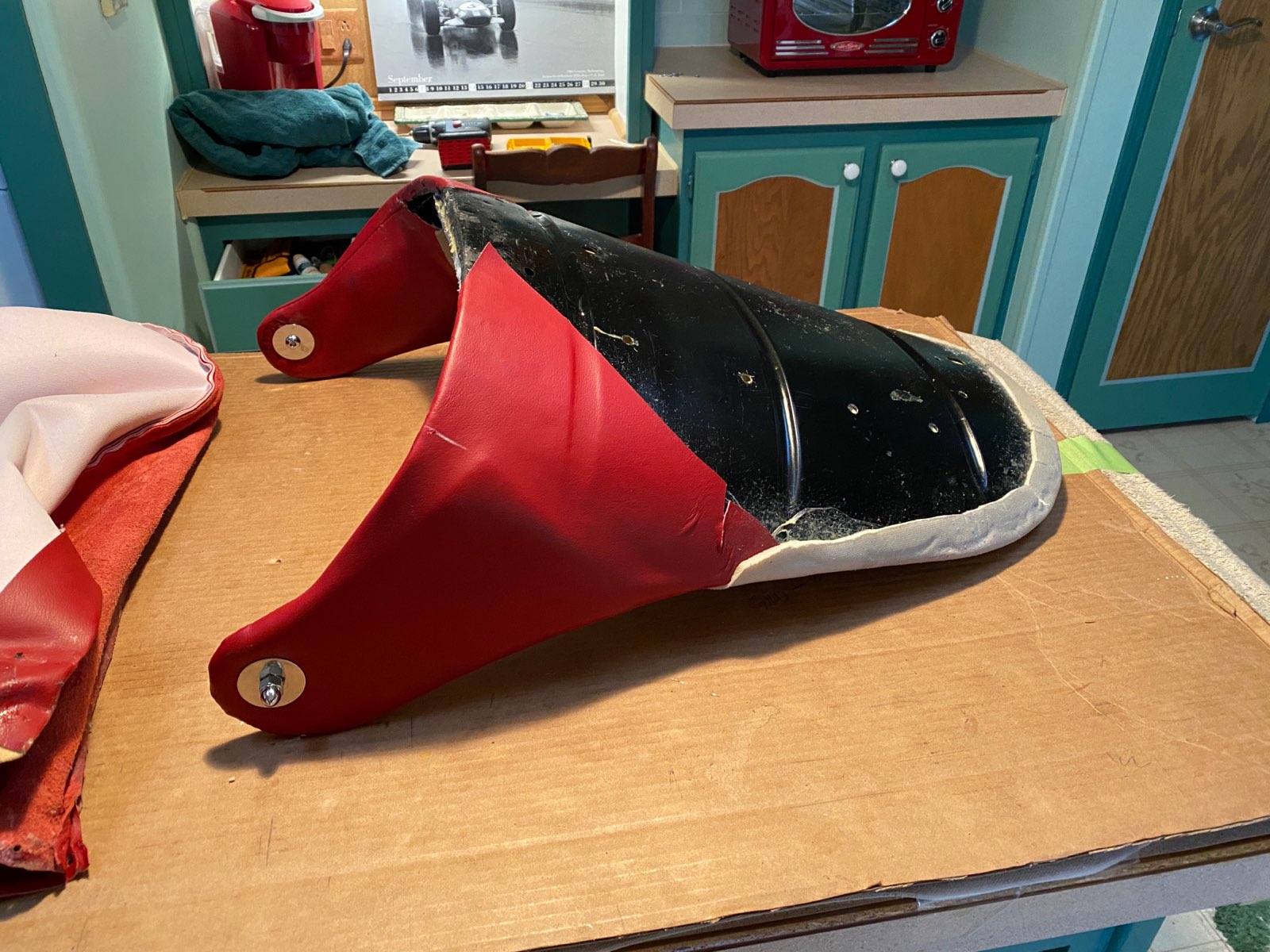

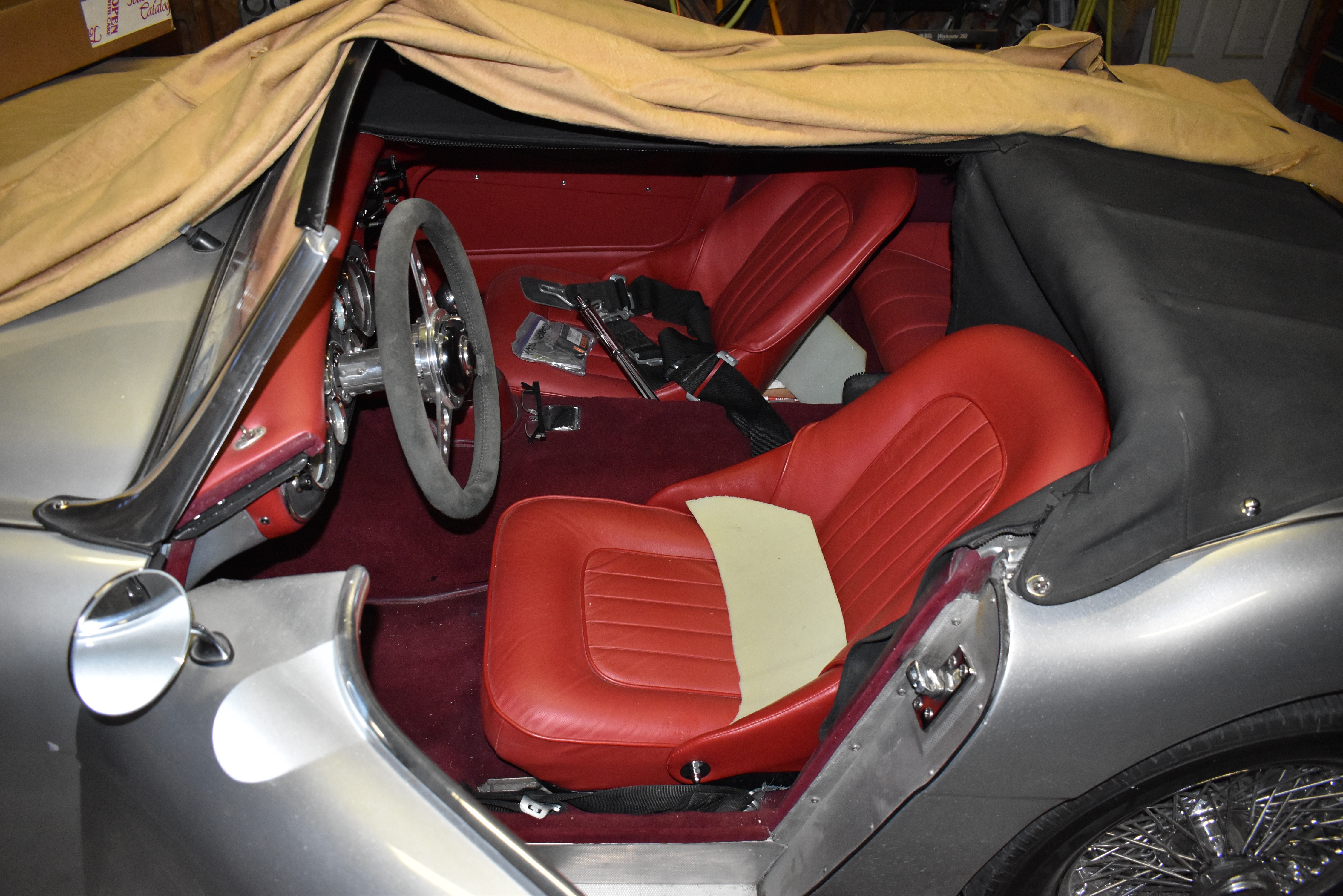

Hi Guys,
I realize this post is very old and unfortunately Ray has passed away but I wanted to show everyone the solution I came up with regarding the Seat Back Angle issue.
This is not a modification for the weak of heart but the benefits are well worth the toil.
The change in seat back angle is about 15° but is adjustable and I've never been happier or more comfortable in my life since doing this.
I would start with buying some used seat frame bottoms so you can experiment on them.
I also reinforced the pivot points as shown in the photos and dressed them up with some Chrome Fender Washers, Dome Head Bolts and
Bullet Style Acorn Nuts.
Regards,
Peter Carbone
"I don't race my car but I drive it like a race car"
