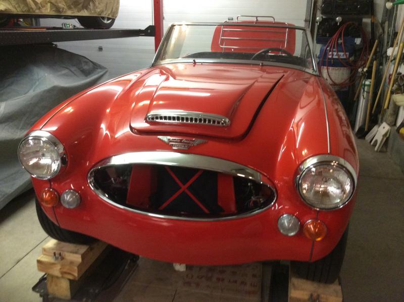

Having my BJ8 restored and visited the car today. The grille surround and cowl are on but the cowl doesn't seem to conform to the surround properly. Each side of the surround flares away from the cowl about 1/4 inch where the cowl turns downward at the corners. I looked at other cars in the shop and they all do it but I don't remember seeing gaps on my original. I didn't think to ask to see my original while at the shop.
The new parts came from AH Spares. Are there supposed to be flares there or should the surround tightly grip the cowl all the way through? Sorry I couldn't give a better description. (and for the pic being sideways) Thanks

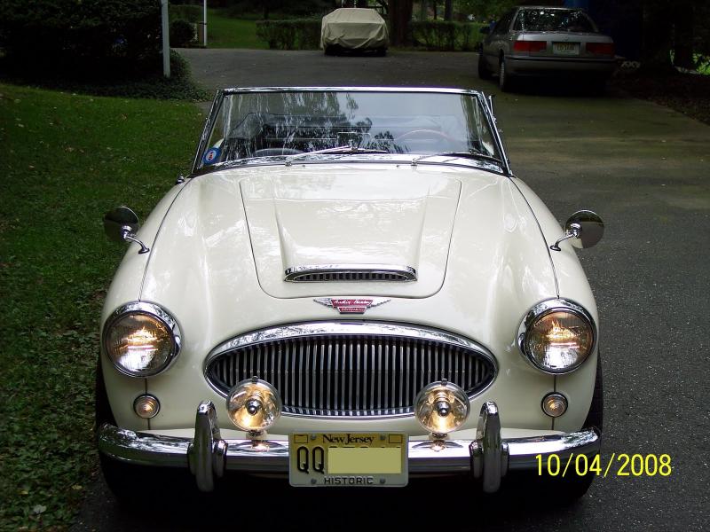

Hi Rick,
Sorry, but I must be missing something as I do not see the issue when viewing your photo. Can you provide close-ups of the areas of concern?

Hi guys
Thanks for the replies. Marv, mine does look like yours from a distance and I should have taken more detailed photos of the areas. But these are great guys to work with who have done a lot for me and was playing down the issue until it started bugging me in the way home. As I understand it the rolled lip of the surround fits over the cowl when installed. In my situation that rolled lip is not following the shape of the cowl at the "corners of the mouth". Instead of following the curve of the cowl tightly there is a gap on each side where the surround does not follow the cowl shape closely enough.
I suggested the shop compare my original parts to the replacements and that maybe just some hand fitting would fix the issue. If need be I'll go back there and take more detailed photos.
Rick
64 BJ8 original cowl/lip and mouthpiece repaired and rechromed .
reproduction parts simply dont cut it , they are cheaply made and rarely fit . Your better off spending the extra $$ and using the originals if possible .

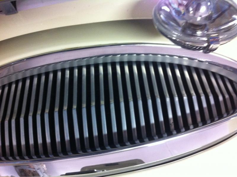

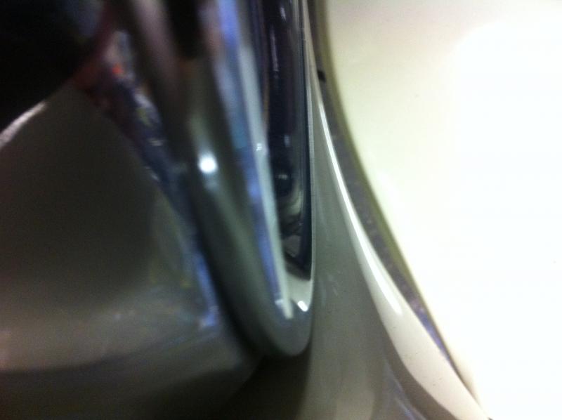

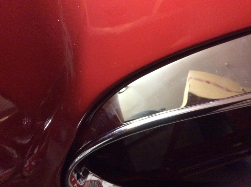

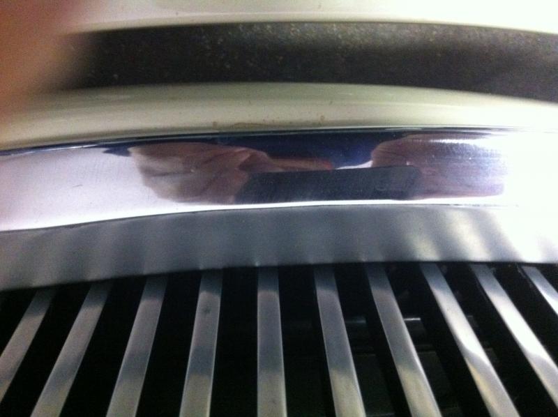

Hi Rick,
If any part of the forward portion of the top chrome cover of the surround is not set into the rolled lip, then it should be corrected. The first picture of my original grill/surround presents my presents one side of the grill surround although reflection has encumbered a clear presentation of that fact. Additionally, picture 2 and 3 show the area that was painted silver to diminish reflection of the grill and have it verticals appear as if they were bent.
Hope this is clear,
Ray(64BJ8P1)
