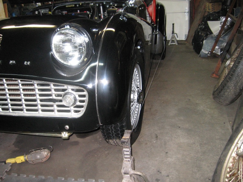

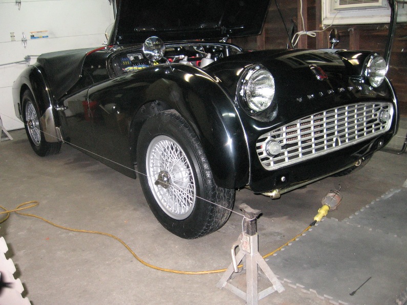

I used the string method after I completed the restoration. Probably not as easy as Randall's method, but I had four jack stands and string laying around, so that's how I went. The biggest problem with this method is tripping over the string and jack stands in the narrow confines of my garage. :glee:
