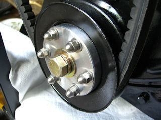

I had installed the Moss narrow belt conversion with a dampener pulley a couple of years ago.
it seemed to perform well & I was happy with the results.....right up until the pulley failed.

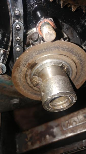

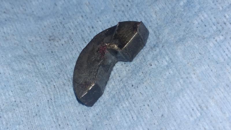

turns out the woodruff key was only partially covered by the pulley boss. But you could not see that from the front, because the spacer blocks your view.

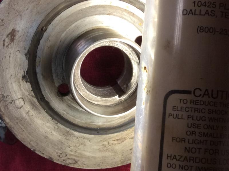

the key gradually rockered back and finally broke off, allowing the pulley to spin on the hub, wallowing the boss out & worse, fretting the end of the hub.

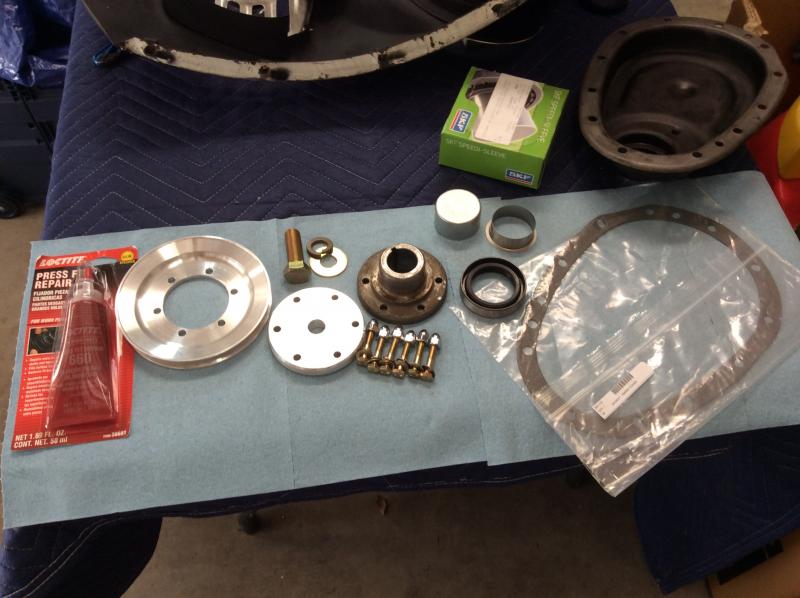

i decided to go back to the original pulley hub, with a bastuck narrow belt pulley from BCNW, and a hub terminator from Patton Machine shop.
the original pulley hub will cover the entire key slot & can utilize the back third of the crank shaft hub ( unfretted) for max support.
in addition I will use loctite 660 to "build up" the fretted end.
(this was a Mazda fix pointed out by Art [Martx-5])
the hub terminator supplied by Patton Machine shop is high grade aluminum, not to heavy, but adds balance ( I hope, since the new pulley is non-dampened.).
so now that I have all the parts, I will start the reassembly soon.
