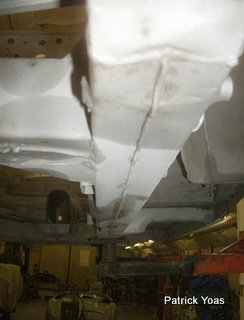

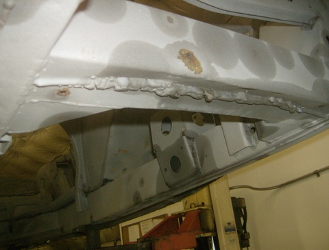

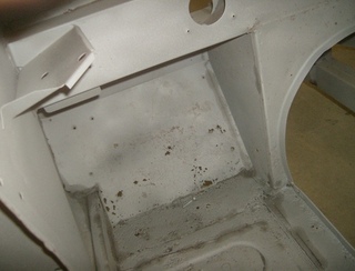

While I understand your desire to get the car right, what some of the posters here are trying to express, I think, is that a frame replacement on any car is a big job, but a frame replacement on Big Healey is a huge job. Unlike a Triumph TR or MGA, the body does not simply unbolt from the frame, it is welded on in many places, the outriggers, as well as around the bulkhead and other areas as well I believe. Hard to completely remove the frame without upsetting the structural integrity and alignment of the body, which I why people are saying it is something you generally only do with a full, frame off restoration, because that is essentially what you will need to do with the body, lots of man hours as well as plenty of opportunity to mess things up. If you still want to do it more power to you, and I do understand your concerns, if the rust is fairly pervasive a patch a cut and patch approach does not seem that great an idea either. You certainly have the right idea of doing a thorough analysis of the existing condition of the underbody with some sophisticated diagnostic tools before you decide what the next step is.
