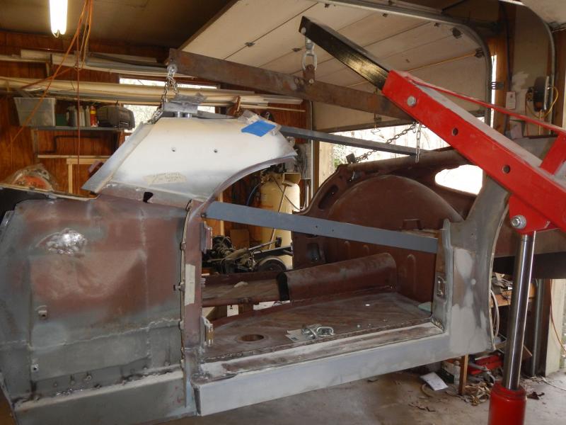

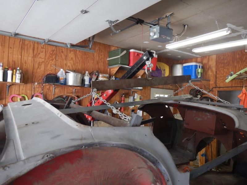

If you have not yet removed the body from the frame. Then I suggest you STRONGLY consider welding braces between the door openings. I as well welded bars from side to side to those braces in the doors. This provides a much better support once the body is off of the frame. If you weld the braces inside the body from the door openings rather than in the actual openings then you can test fit the doors later on with the braces in place. I used 1" square steel for these braces and found that it worked very nicely. Those braces do the most good if welded near the top of the door openings.
I used some Industrial shelving braces that I had on hand. Also I made a lifting rig so that there was little folding force applied to the body. It worked well and the chains allowed me to flip the body on it's side by my self.
David
David
Yes I was able to rotate the body using my shop crane . My methods were a bit rudimentary . After seeing what you did I think I should have used the engine tilt lift in my operation. It would have helped to turn the body.
