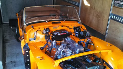

I will be at Triumphfest. Look for the TR3A in a Tangerine color. NO fenders, doors etc. It should be the only one there. It has lights, turn signals and such that I can drive it but the fenders and such needed repair from my painting experience. I have not decided if I will drive it to the Sonoma raceway, it does not have any break in miles yet. But maybe that will be a nice 18 mile drive that will be good for it.
Jerry
