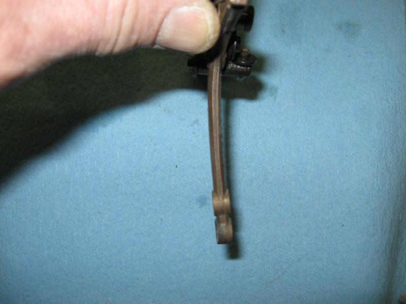

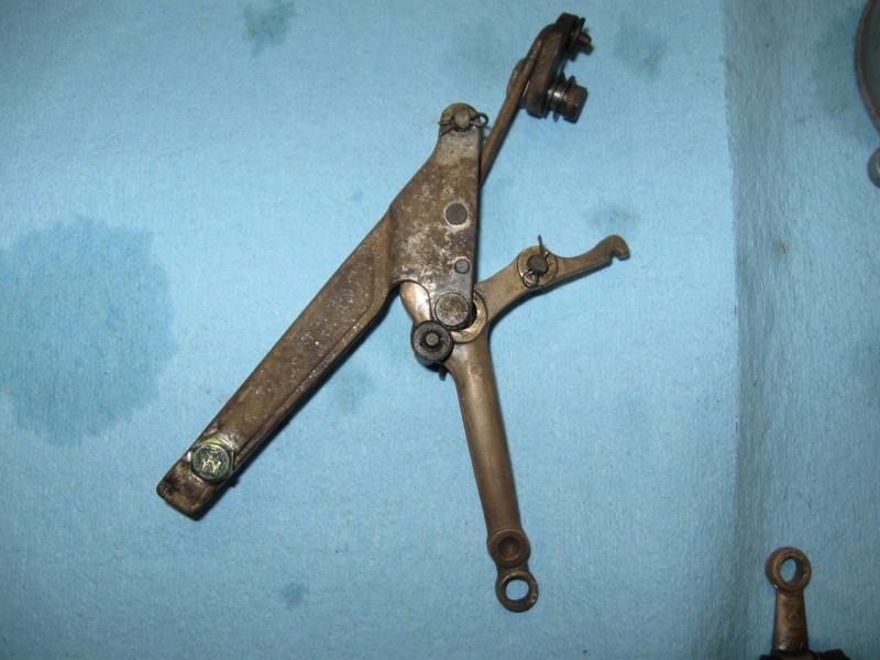

Is the front carb Jet Lever supposed to be bent toward the engine? See pictures attached. There is a wiring harness that runs along the engine compartment and I am wondering if it was bent inboard to provide more clearance? This car has a tr4a intake manifold if it makes any difference with the location of the carbs vs side of the engine bay.

David,
I can't tell why it is bent. I didn't notice it until I was cleaning the carbs in preparation for a rebuild.
Thank you all for your timely responses. For now, it stays bent!!!
When I pull the head on the TR3 I drop the jet and that mechanism down out of the forward carb so I can just pull the manifolds back far enough to clear the studs on the cylinder head.
If one does not remove that, it can get bent as it presses against the inner wing.
I guess I should disclose that I found at least one in my carburetor bin that is absolutely dead straight. Tom

Comprehensive to say the least (thanks for the link) and the rationale for the bent arm seems appropriate. Logic would seem to say that keeping the cable pull, linkage and levers as close to one plane as possible would make best use of the force required to choke, so perhaps the conversation here is inconsequential.

Lots of interesting theories, but in the factory photo in the Practical Hints it sure looks straight to me:
I'm sticking with many being bent when pulling the manifolds back to remove the head (or to remove the manifolds with the carbs still in place).
Note that the yoke for the rear connection sits totally on the inboard side of the lever - this provides clearance for the cable w/o resorting to a bent lever.
