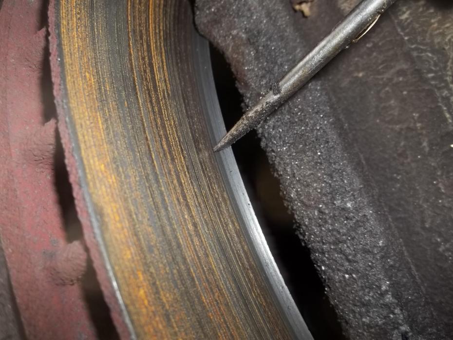

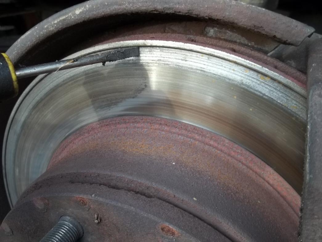

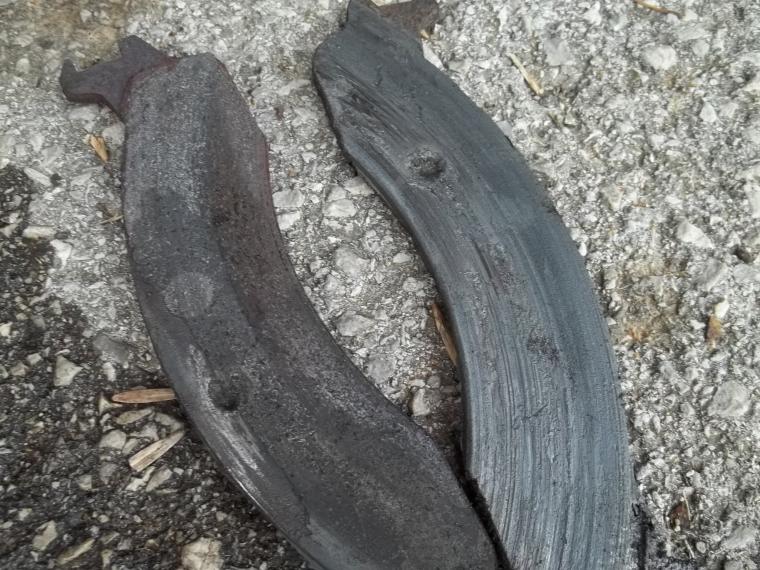

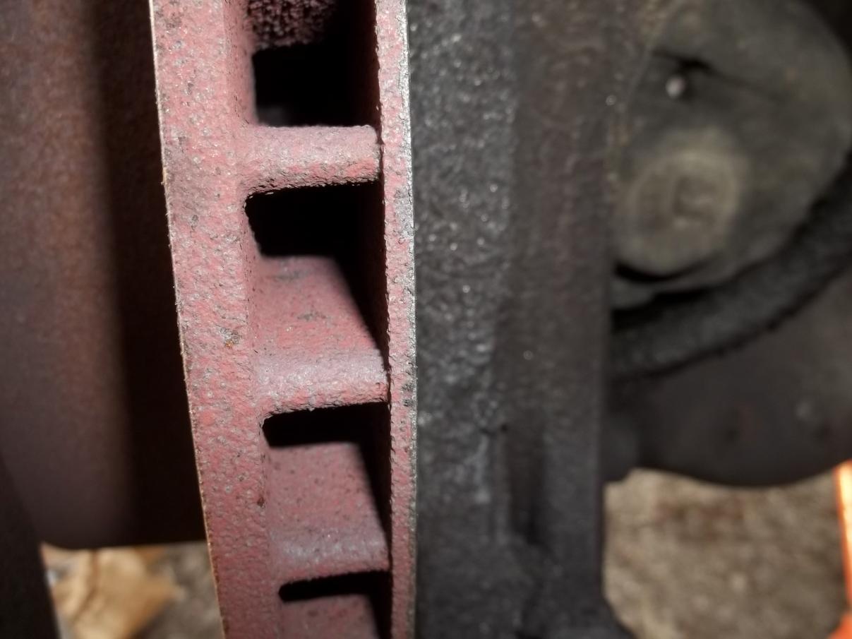

My 1995 F250 4wd had a brake rubbing badly. The caliper is leaking fluid and pads are shot. WEhat about this rotor? Can I get away with a new caliper and pads? Thanks.
IMO, that rotor is shot. Wafer thin on the worn side. They aren't that expensive and after all, it IS kinda a good thing to have decent brakes, Gar. :wink:
I agree with doc.... new rotor with new pads. I've used Rock Auto; if you can wait for shipping their prices are good.
Ditto what Doc said. I often change rotors just as a matter of course. They are not that expensive. About $36 Dollars at Auto Zone in fact. Sometimes you can "turn" them, but if they look like they need turning, I'd just replace.

The way the rotor is worn indicates a dragging caliper. Check the rubber hose and replace caliper, rotor and pads. You are in it this far do it all and make it right. If other side is scored, might as well do all and elimate all noise and rework.
Larry...That's my plan. As soon as I 'get to it"... :smile:
