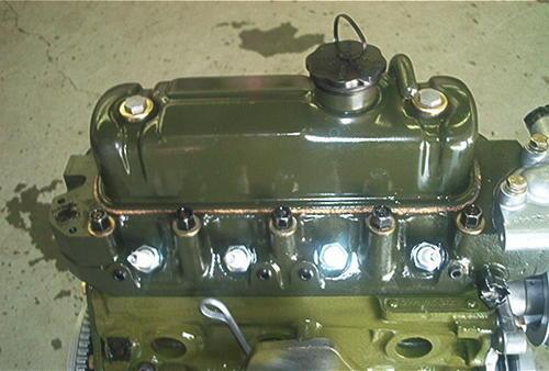

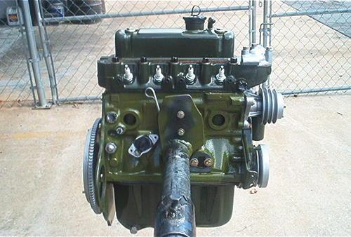

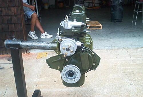

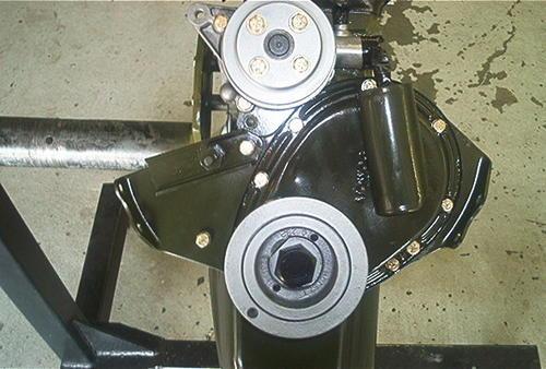

Hey guys, something to wet your appetite with, it won't be long now /bcforum/images/%%GRAEMLIN_URL%%/smile.gif This one is headed for TN, he originally just wanted a stock rebuild, because he felt that's what his budget would allow, however since I only use good replacment cams, might as well get a performance cam, same money, I opted for the APT MD276 with a slot drive oil pump, and APT CF-04 lifters and went with the AE-21253 pistons which bump the compression ratio with a taller compression height. So for less than $100 more in the cost of a stock rebuild, this guy got 9.75 to compression and a hot cam, it ought to be a great little motor with added performance, these two items ( cam and the pistons) are good bang for buck performance add-ons. I went with a BMC olive green paint job, I really like this color.
