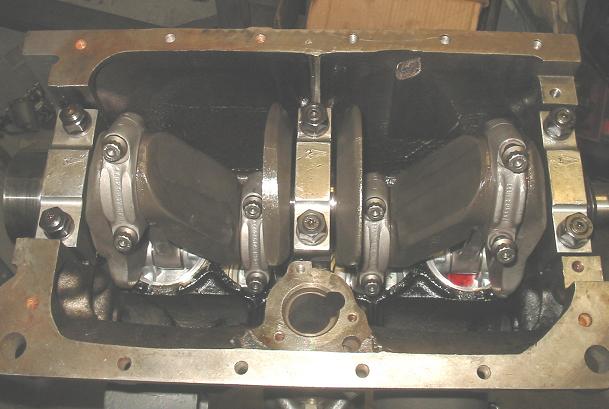

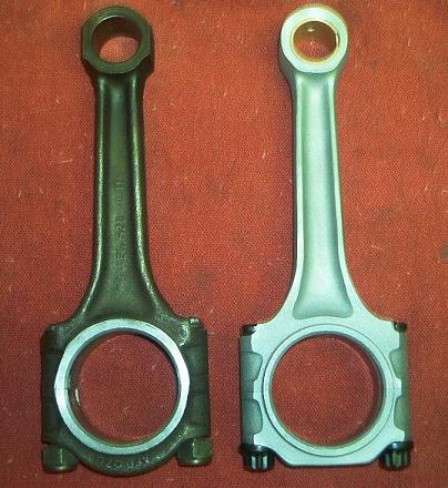

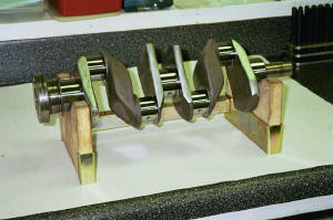

Lessening rotating mass does not create more horsepower, it will however allow to get to what you already have quicker. In racing we lighten stock rods and cranks as well, in the SCCA full prep rules you can do this by buying a billet crank and Carrillo rods, in limited prep you have to use stock rods and cranks, but you can lighten them. here's a picture of a 1275 crank that I wedged lightened (about 3 pound reduction), and then a before and after look at a 1275 rod I lightened (about a 100 gram per rod reduction), plus the polishing of the rod help to strengthen it.

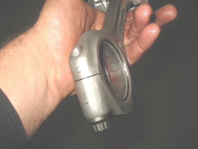

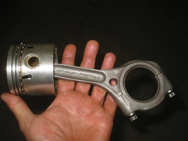

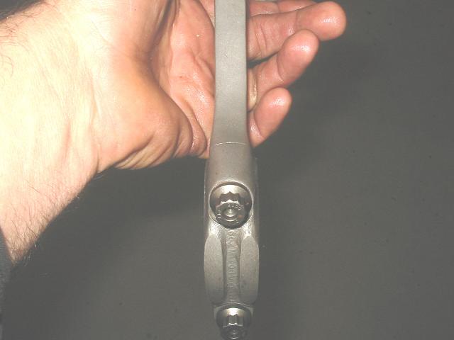

And not to leave out you 1500 engine guys, here's a set of 1500 rods I did.

not to sound like an idiot, but can you define "wedge" as it refers to a crank and/or rods?

Wedging a crank is the process of removing excessive material from the "pin" side of each counterweight. The A series cranks do not have enough counterweight but it would be silly to add weight to one side when you can remove it from the other...
Kind of a statice vs dynamic balance thing, little bit pricey but depends what you want out of your motor, probably not worth doing unless you rev it to above 6 or so on a regular basis.
Hap please correct me if I am in error.
umm...ok...what is the "pin" side of each counterweight ?
do you mean (and i reference hap's pic above of the crank) the areas opposite the rod journals where there is a large chamfer?
mark
The pin side is the connecting rod pin. The journal. These cranks were under-counter balanced. That is to say that the counter balance on the crank has much less mass than the crank web, journal and connecting rod sitting directly opposite it. By reducing the web closest to the journal, this helps bring the crank back into a better balance. This trick is not noticable on either a static or a standard dynamic balance machine.
Generally on a crank, static balance is nearly useless. And stnadard two point dynamic balance will only keep each end of the crank balanced. The deal here is to help, especially the center main bearing, where it has two "heavy" journals and connecting rods on one side counter two not-so-heavy counterbalance weights on the other side. Same deal with journals 1 & 4.
