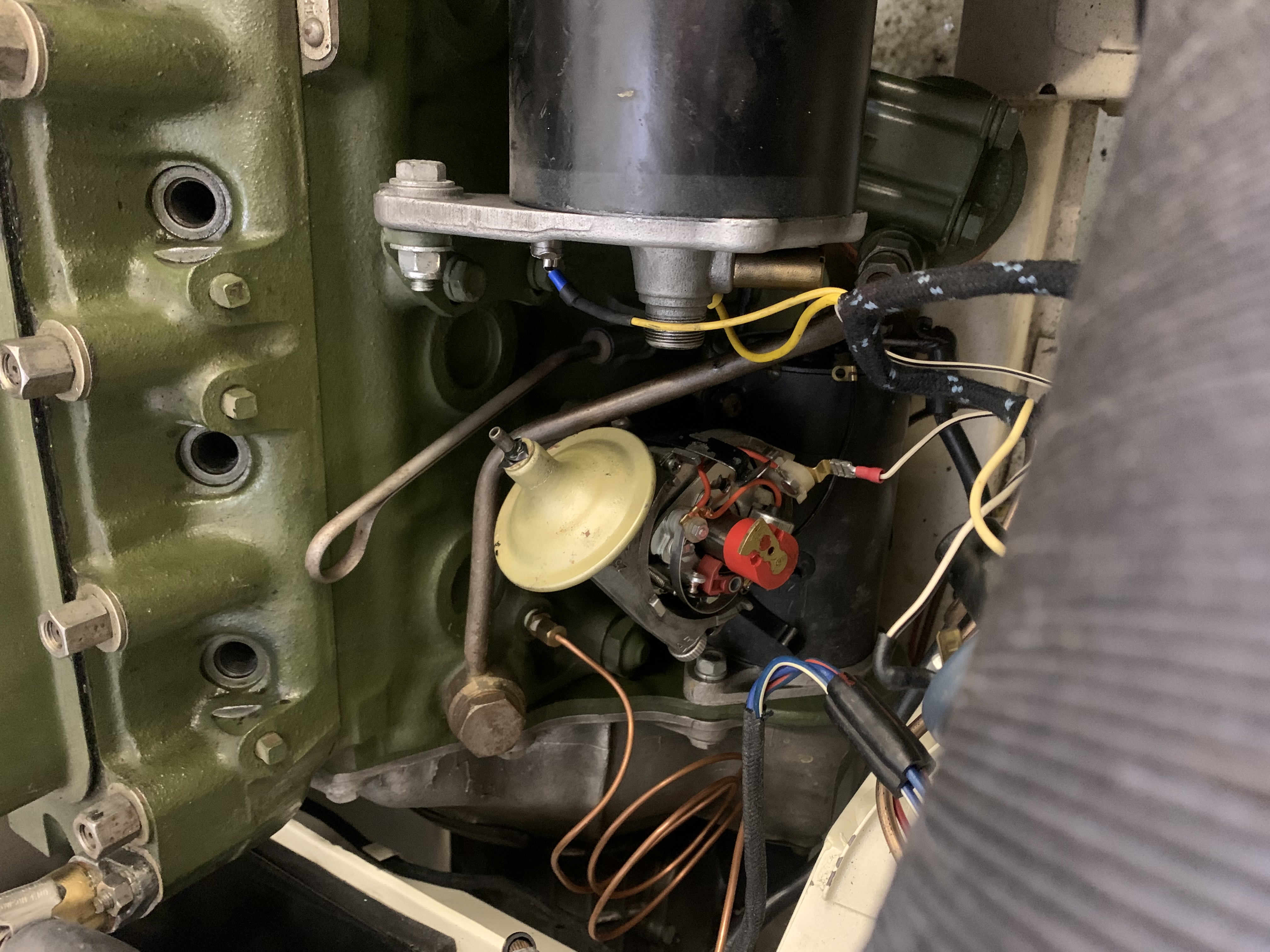

When setting timing on my 1275 (in a bugeye), the distributor vacuum advance canister hits the oil filter pipe preventing advancing beyond about 5 BTDC.
I have been advised that my distributor is "one tooth off".
I've removed the distrubutor using the 2 bolts on the block retention bracket. I can't see into the hole with the engine in the car but can feel the slots on the shaft with my finger.
What do I do next? How do I correct the "one tooth off" problem from here?
thanks for any advice,
Fred
They mean the teeth on the shaft that drives off of the camshaft. That shaft is threaded. Get a long bolt to thread into it. Use that to carefully pull the shaft out and rotate it one tooth. You really need an experienced friend to help… and need to be able to see the shaft.
