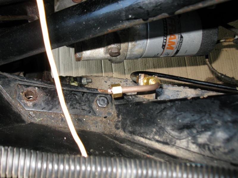

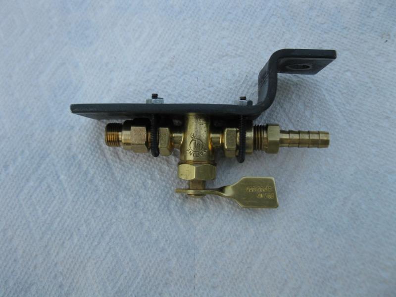

Fabricated a replacement using a Moeller valve. This a plug type valve and is used for gasoline shutoff in boats. It seems these marine guys are not keen on valves that leak gasoline. I removed the old valve and installed a ninety degree elbow and then the new valve. The valve support is bolted to the body using a nearby body bolt. No good pictures of the entire installation but here is one of the valve Also attached a picture of the elbow attached to the old line and the body bolt removed, ready for the support and Moeller valve to be installed. Have other pictures and a document write-up if anyone is interested. Sorry the valve picture is upside down.
