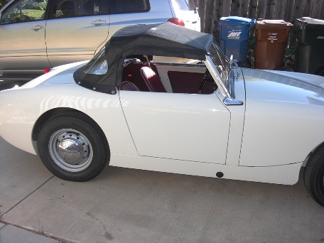

After doing surgery I was able to get the top mounted. In several increments I wound up cutting an inch off the bottom of the bows. It was still a struggle to attach the top but it is in place for now. I will be going to a cruise-in later this afternoon and I want the top off for it but after that I'll put the top back on and just leave it on for the season.
