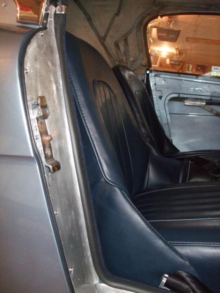

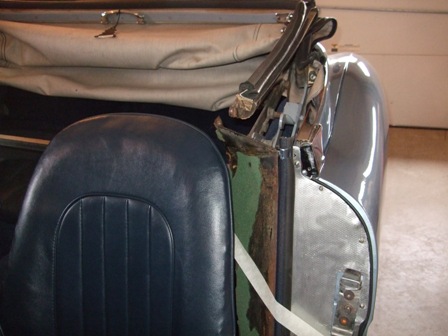

If someone wanted to know what the Bristleflex from McGreagor looks like, here some pics. It look great and works great. It's been on there all summer and someone drags their foot across it now and then and it stays put. The tensioned steel is inside the fuzzy part which slides unto the steel edge around the door. the Aluminum shut face finisher just slides behind the rubber part. You'll have to ignore some of the butchery on the aluminum finisher as it was chopped up pretty bad from before and I too want to guard my dollars. Buying new ones would not have made the car ride or drive and more enjoyably. Also at the top I was not knowledgeable about how it was to be finished and I cut it off at the wrong spot then had to make do.
