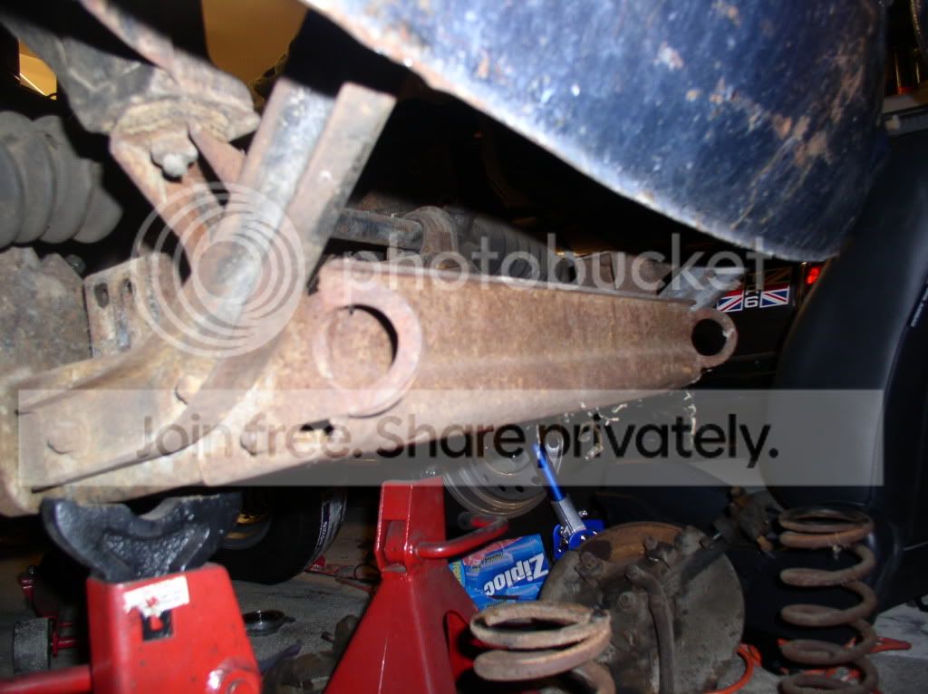

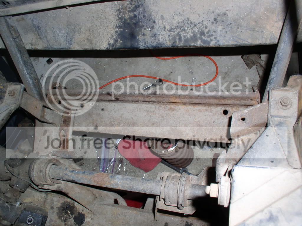

Guys - is this correct radiator extension to use mount a front sway bar on the TR4A? I don't think so but I wanted to double check.

Does the existing radiator shield just unbolt.
Sure does which is what makes adding the TR6 sway bar an easy upgrade.
Looking at your picture, I think the top bolt is shared with the bumper support bracket so you'll have to at least loosen that as well. Sorry I can't be more specific but it's been a long time since I did mine.
