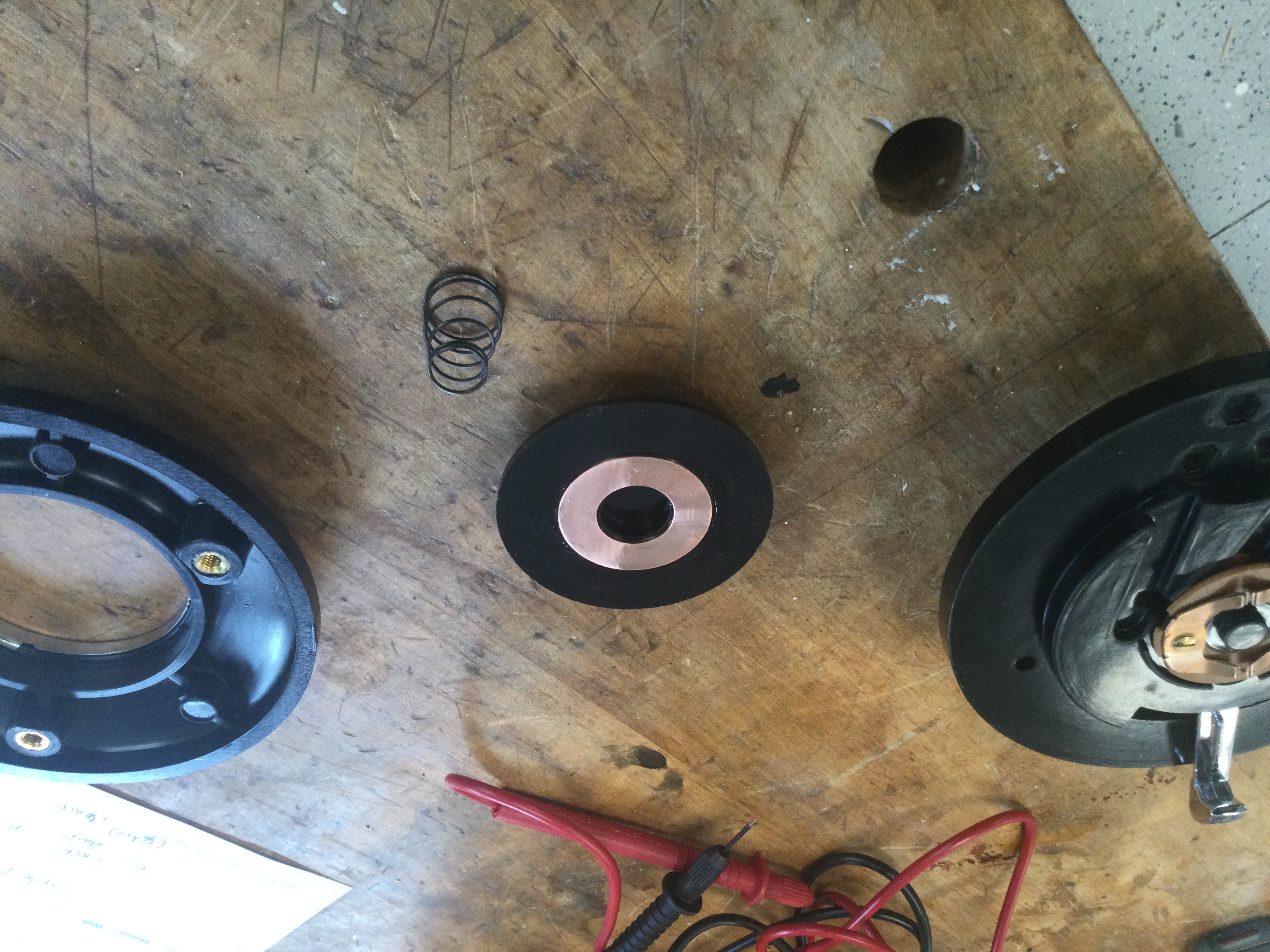

Just to follow up, the issue on mine was the copper washer had become unglued from the plastic housing, so was able to make contact with the two brushes, sounding the horn. Just waiting for the epoxy to cure now so I can reinstall it. I’m becoming quite an expert on Trafficators!

Ahhhh, just reread this thread, and John had the same solution a month ago. Not surprised!
