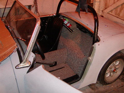

Here is how I mounted my Halotron fire extinguisher. The rollbar mount came from Pegasus Racing Products. It is easily and quickly accessible.
Oh, and pardon the epithet.
I guess its time to replace this one.
