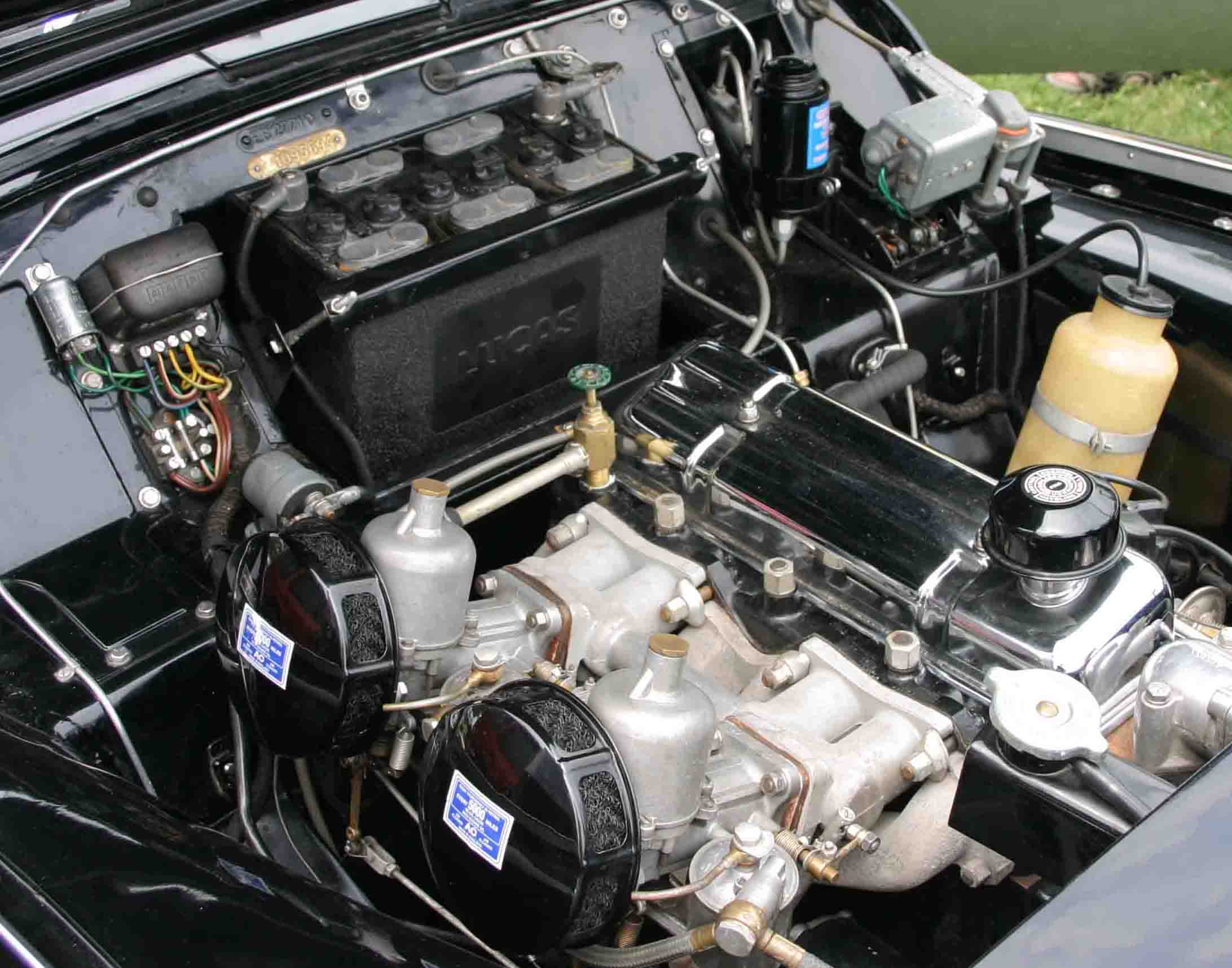

See the attachment how the Hirsch paint still looks on my cast iron exhaust manifold after 15 years and 85,000 miles back in 2005. Before painting it with a small brush, I had sandblasted it clean.

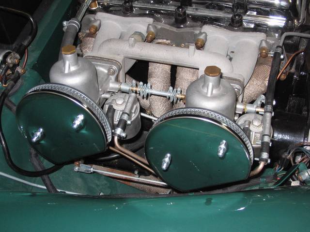

Tom(I Gather) here is a shot of my 71 manifold. I had it coated silver. Changed my mind and went with a later year and coated it black(it's on the car now) and hooked to SU's
When the TRs left the factory they were bare or just starting to turn brown with surface rust. "Originally" when they came out the sand mold, they had to be blasted to get all the sand out, milled for the flat mating surfaces and tapped for the exhaust studs. I assume they looked like what I have on my TR3A. (See attachment above). No judge at TRA or VTR ever told me it was wrong. Clean cast iron is usually a grey colour. Chrome or black would be wrong. If you can be sure to get a ceramic coating that is grey or towards a dull silver and not too glossy, that might be an answer. I know a TR4 owner with a restored concours TR4 in Hong Kong who painted all his cast iron parts with dull gray spray paint to make them look like the fresh casting colour.
