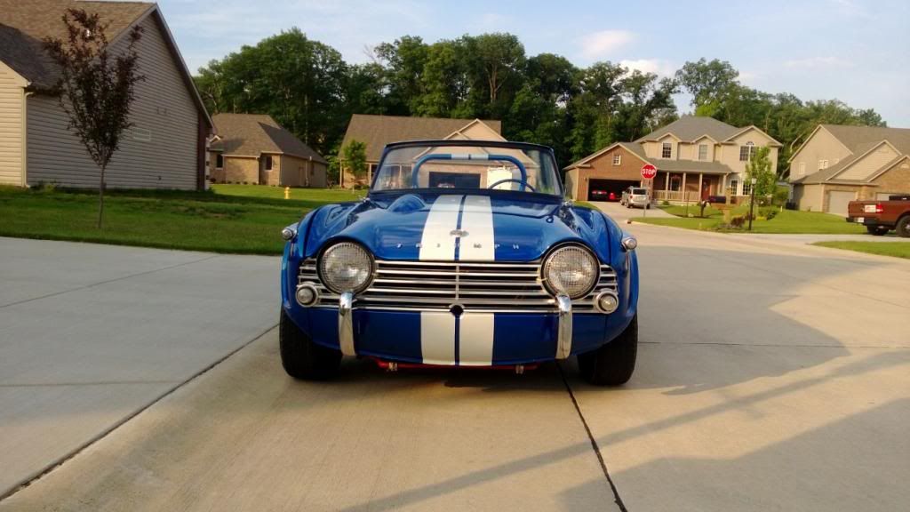

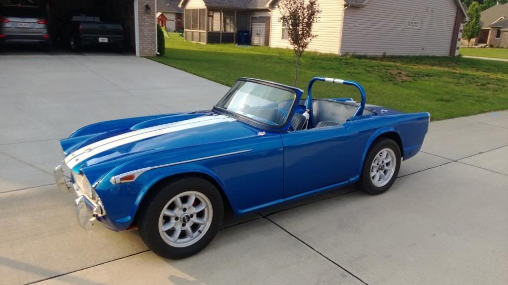

My name is Dane Joslyn and I've been lurking for quite a few years and I'm finally getting around to introducing myself. :D I've got a 1965 TR4A that I inherited from my uncle that had been pretty big into triumphs. I wanted to make sure someone in the family continued his addiction :cool: His name was Mark Joslyn and I'm not sure that he was a member here but I'm pretty sure he has some friends that were or are members. He was well known in the Champaign Illinois area and I'm pretty sure he was the president of the Central Illinois Triumph Owners Association for a while.

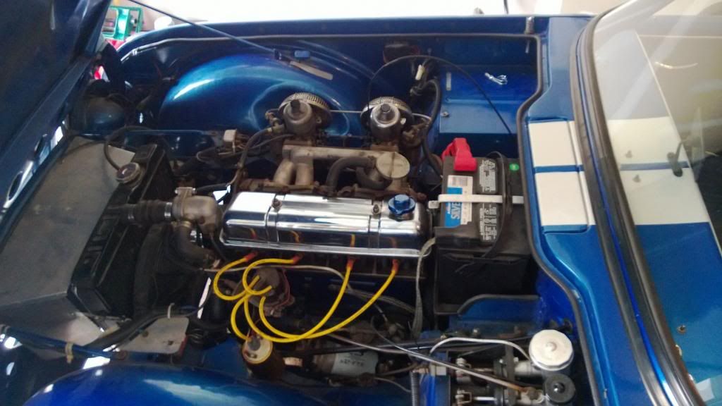

I have a feeling he bought the car mostly as it sits now. We never found any paperwork for it other than the title. It seems to have been setup for some vintage racing or to at least appear like it has been. It is equiped with and E-fan, GM alternator, aluminum pulleys, it has the oil filter adapter to fit a modern filter. I'm guessing here but I think it may have a modified camshaft in it as it idles like it has one. I also have a paint matched half height plexiglass windscreen to replace the one currently on it.
Unfortunately it has a bent frame just behind the drivers side front wheel. So it likes to pull and wear tires a bit unevenly. But it is still fun as **** to drive.
Anyway, I'm sure I'll have some questions for you all but for now on with the eye candy.

Welcome Dane!
I never met Mark but he was well known in the Triumph circles and it was sad to hear of him passing. I like the looks of that 4A, someone put some thought into how they wanted it to look - shaved door handles, 3A bumperettes in front, looks great! Enjoy it!
I thought as much too. Horns have been removed, windshield wipers and anything to do with climate control is all gone.

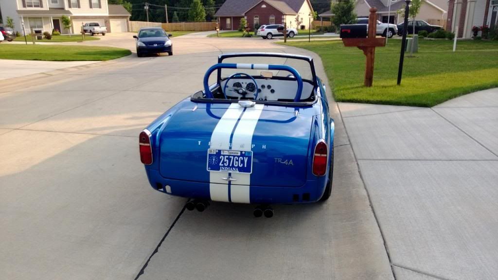

Welcome Dane,
That is an extremely handsome car with very clean lines. The color combo with the white stripes "pop". I really like the bumper delete and the 3A bumperettes. I have been considering deleting my bumpers as well. Also, very interested in the quad exhaust pipes. Do you have any info on those?
Cheers and look forward to your future posts
Bob
Bob, the exhaust Y's about 18" after the header and goes into what i'm guessing are glass pack mufflers which then dump right to the exhaust tips which are just a Y tip giving the quad look.
