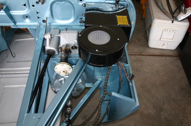

Ok, spent the better part of the day in the garage and managed to finish the heater box restoration and install, and also the brake master cyl and the servo and slave cyl rebuils and install. Here is a picture of the work in this general area today (Attached) -- Basil
(Note the restored pedal boxes and the servo bellows can which was re-plated this week).

Re: 26 May 07 - Finally back to it
Well, at least one person got something done and lookin' good Basil! Looks very nice!! /bcforum/images/%%GRAEMLIN_URL%%/thumbsup.gif
Drop dead beautiful. /bcforum/images/%%GRAEMLIN_URL%%/iagree.gif

Thanks guys. Tinster, it will be a looooong time befor I run out of things to do on this car!

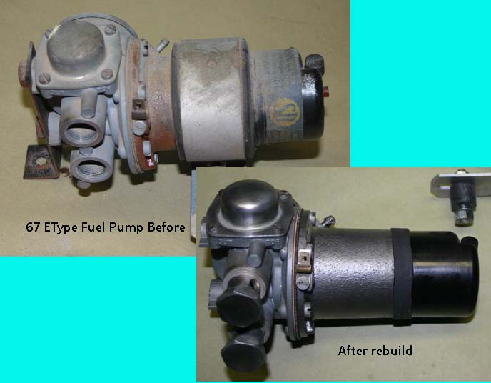

Tonight I finished the rebuild/restoration of my EType's fuel pump. Before and after pics attached. Now all I have to do is figure out how in the name of all that is h oly do I get the new fuel line onto the banjo unions!

Re: 31 May 07 - Finally back to it
> ... how do I get the new fuel line onto the banjo unions?
Cut the old line off the banjo bolts and drill out the hole to fit the new line. Silver solder or braze the new line to the bolt.
Don
