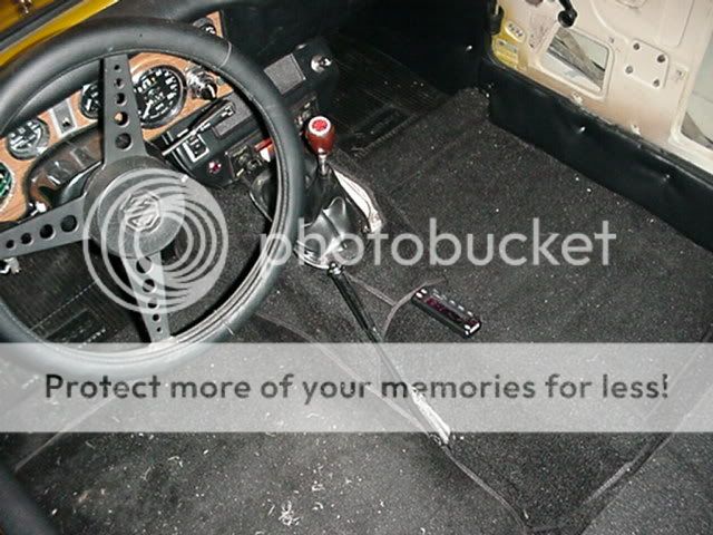

I steeled myself and went back at things today. I finally got the windshield completely installed. What a total PITA. I think the problem was worse because its so cold in my basement and that made the rubber harder. But that is done. I feel much better making some progress and getting over a hurdle that had been bugging me. I made some shims out of 11 gauge metal and used them. Ah, a small victory. Still a long ways to go. With that done though, I decided to drink a brew and snap a few pics of my screw ups and other junk. OK. in this first picture I have these four shims that I originally thought were for the windshield but the holes are two close together. Anyone know what these are for? I must have left them out somewhere. The next is of the brand new emblem that I ruined with the 3m emblem adhesive. Next the nostril that I accidentally drilled up through the hood when installing the surround (which I am still not happy with). Then just an interior pic. And the next is another problem. The vent window to windshield seal. The rubber lips that are supposed to slide into the channel are too narrow. Has anyone else had this problem? I ordered the seal for the right year.
