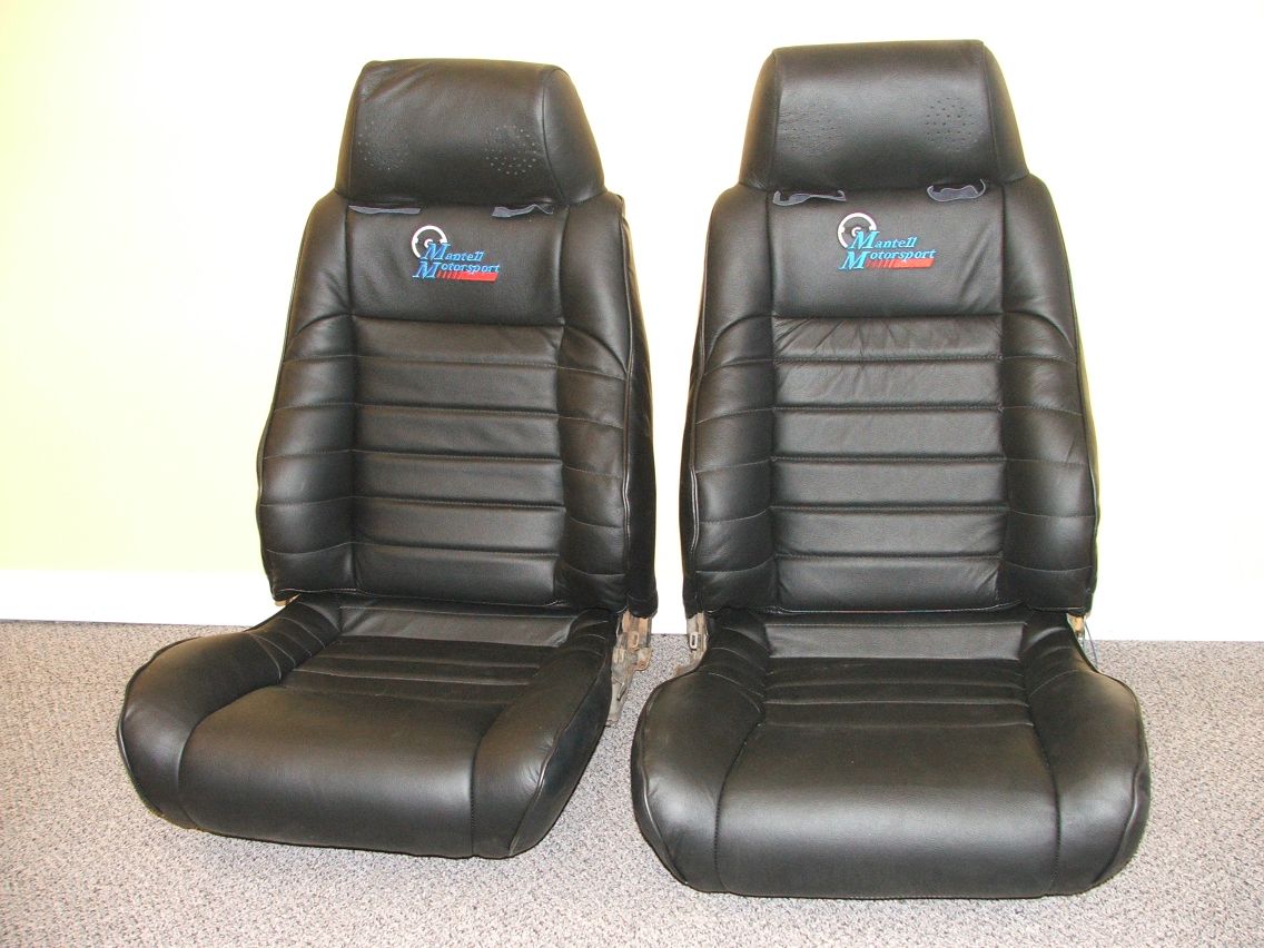

I finished a pair of Fiero seats for Pete Mantell of Mantell Motorsport this week....

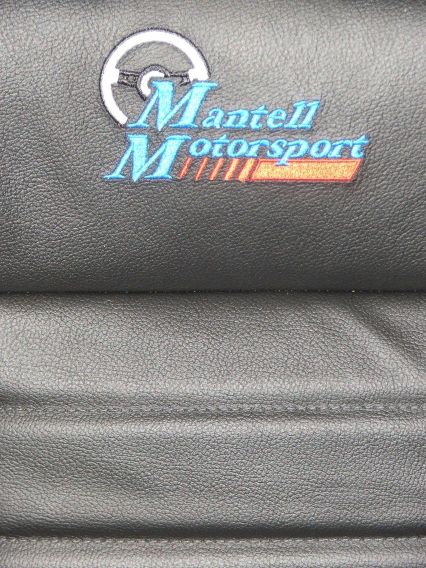

The seats are sitting low because the seat rails have yet to be bolted on.....Mr.Mike did the embroidery work for him.
I installed new speakers and rebuilt the seat bolsters and added some body to the seat bottoms. Also cut slots for the shoulder belts (which is why the leather flaps are still exposed...they will disappear after the harness is installed into the seat.

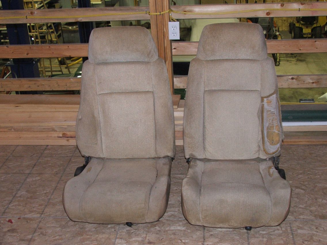

BTW - Pete's seats were in similar condition to this when I started:

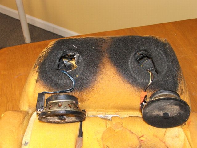

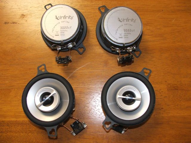

There are several options for speakers available...I used Infinity's on this job. In my opinion, you would be wise to replace the stock speakers when doing this job...the picture below shows the condition that I've found most of them to be in upon inspection...

Infiniti's are great speakers...I bought a batch of Eclipse 8233's some time back and have done a dozen or so sets using them, think I only have 1 set left....however, any good, round 3"-4" or so speaker will work (forget the dimensions right off hand)
These Infinity's were 3-1/2" diameter.
I cut the tabs off before installation...and use the original Fiero wiring clips.

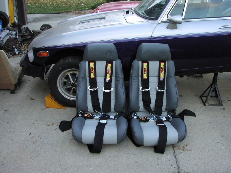

Here's the seats I did for my MGB/GT V8 conversion:
