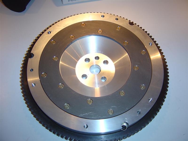

Since my last post got hijacked and got off track I thought I would post my pic of my new flywheel and start over,

I'm not familiar with any flywheels other than the original TR4A and Spitfire ones that I've worked with. So with the Fidanza one it appears that the area the clutch disk rides against is replaceable? I'm interested in why it's a darker material that doesn't have a machined look to it.
Scott
The alloy is too soft to use as a friction surface, so the friction surface is a separate steel piece (which is replaceable separately). I didn't examine it closely, but mine didn't show any machining marks either. It may have been left "as cold rolled", but I wouldn't be too surprised if it was surface-ground instead.

HerronScott said:
Hondo,
Scott
Scott, with any aluminum flywheel you have to have something tougher than the aluminum for the clutch to ride on, so that is what they the call the friction plate, it bolts in and is replaceable, should you ever need to. I've run maybe 3 brands of aluminum flywheels over the years, they are all the same way in this regard. As far as the machining finish on the friction disc, it's surface ground, thats alot smoother finish than any cutting tool could ever provide, same deal as when you get your stock flywheel resurfaced, it's ground not cut.
