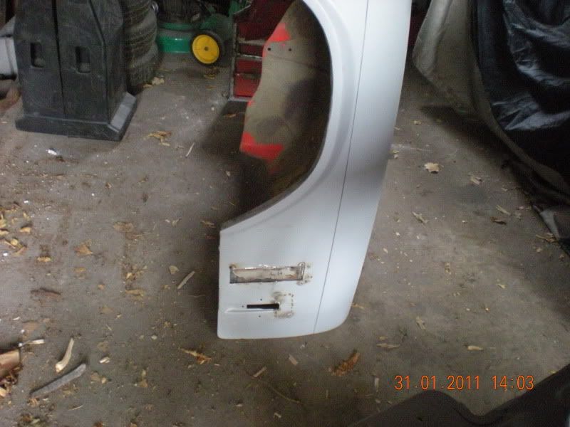

I've installed these on my GT6:
They're hinged to open inward and stay either fully open or closed.
thought about a cable control.
