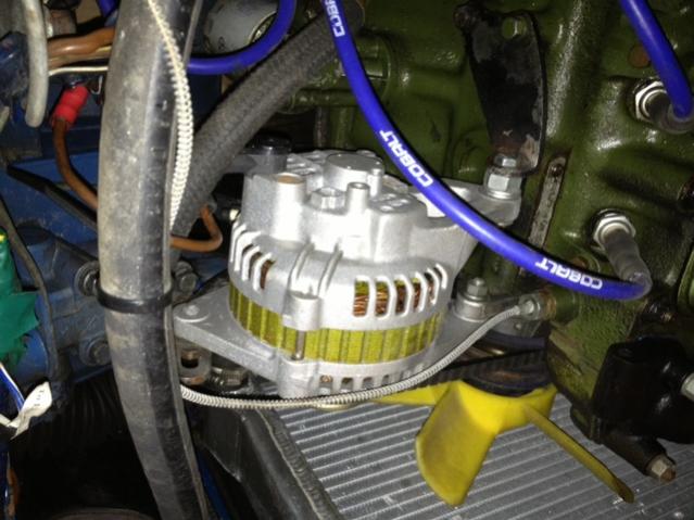

I used the GM alternator. I have used them on so many other applications and they are cheep and easy to come by. It is not the easiest to install. It took me 3 tries before I got it to work well. I had to make a briquette to install it with out modifying the alternator. They are a little big and ugly and I had to move the temp sending unit back to the radiator.

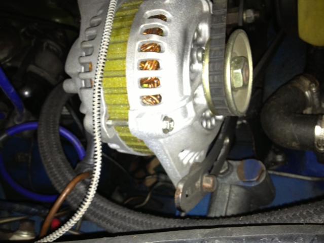

I'm running a Mitsubishi. Any single wire will work.

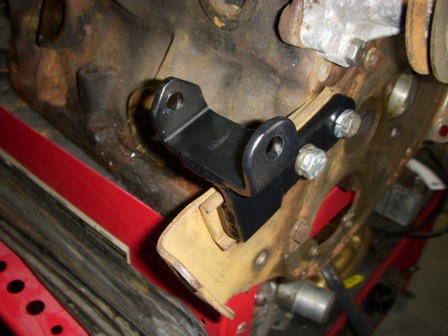

That Mitsubishi looks kinda nice. What model? Do you have an pictures of the backside and wiring connections?
I'm not sure of the model #
The only wiring I did was the brown wire to the single post on the alt.
I went to a junkyard and looked for a Japanese car w/ a 1 wire alt, and three mounting points; two lined up and the third 180 deg across.download.jpg
You can get the warning light to work, but I misplaced the harness connector and have never felt the need to bother with it
I used the same Mitsubishi alternator for years. Mine was free and had a cog-drive pulley so I put a Lucas air-pump pulley on it.
I forget the wiring used but I got the dash light working. It wasn't hard.
As stated, the GM alternators are sort of large (and I've had two of them fail).
