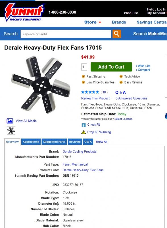

Tom's Import Toy's has a stainless steel 6 blade fan, 15 inch for our engines. Anyone have a review? Looks good in the pictures. $75.00

The SS fans shown above are noisy because they utilize an even number of blades equally spaced

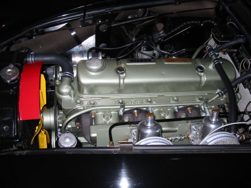

Just FWIW, I used a 6-blade fan from a 1973 or so Mercury Capri V6. It is essentially identical to the construction of the stock Healey 4-blade fan. Same rivet spacing and diameter.
Works really well and looks stock. Got it at a local pick-a-part yard about 30 years ago. Probably hard to find today.

The Mercury Capri V6 is almost identical to the same era European Ford Capri. It used the 2.6 litre Ford Colone V6 which was also used in some Ford Broncos and Aerostars in the US in the 80's, so it should be possible to find a fan in the US.
Ebay has new Derale Heavy Duty stainless steel 6 blade fans listed to fit a Capri. Part #17015, 15". $50-60.

This fan would be quieter than the evenly-spaced Derale BCS sells, however it probably won't fit.
Scrolling down to the Q&A below, the fan is 1-7/8" deep from the mounting surface to the blade trailing edge. This looks to be too much for the Healey as even if it fit, using a thick spacer, it would be right next to the radiator.
The BCS Derale above with its 1/2" spacer clears the crank pulley and nut with 1/2" between the fan and radiator top tank. It makes a whirring sound noticeable at low speeds and idle, but you get used to it.
