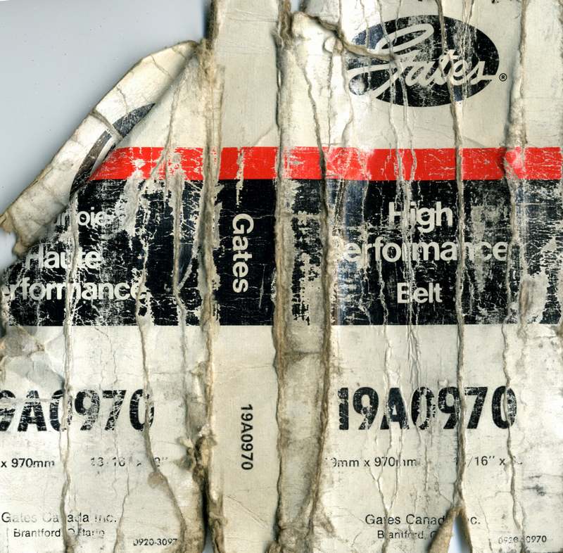

The Gates cogged belt I plan to use in my TR3A is 19A0970 for 19mm wide by 970 long. The packaging also reads 13/16" wide by 30-something as it's too hard to make out. It is marked "Gates Canada" and it has been the spare belt I have carried in the boot since I bought it back in 1993 or 1994.

If you get a belt that is too long, you may have a problem with the tensioning. That's the bracket that supports the front of the generator and if the belt is too long, the generator may be at the outer limit of the slot in that support bracket. But since your belt measures 3/4" rather than 13/16" wide like mine, your belt will probably sit higher in the pulley grooves and will probably be OK.
