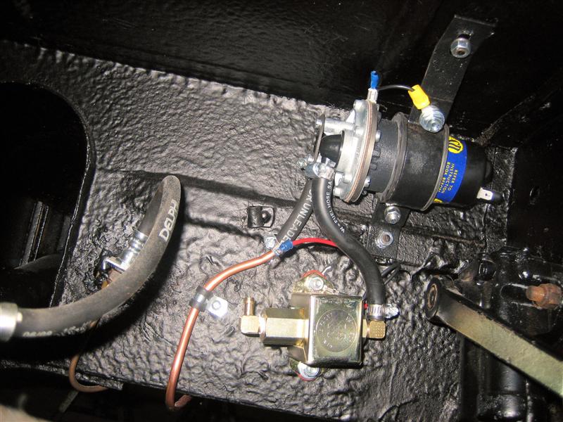

This is the Facet pump that I installed for a backup pump. It is mounted on rubber mounts and is no louder than the SU pump. All it takes to switch pumps is to flip a toggle switch.

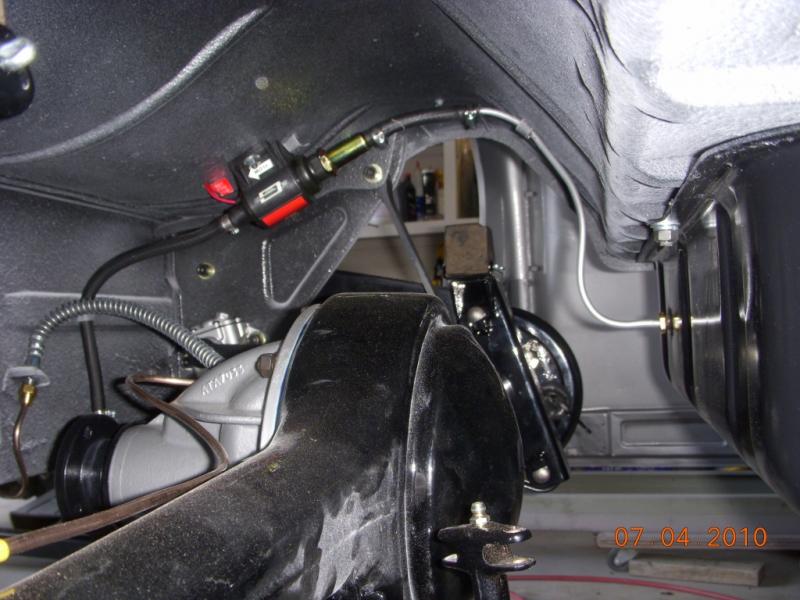

I had a Facet pump in my Bugeye, and it worked out well. I installed one in my 67 Porsche 912 too. In the Porsche, I use a somewhat higher pressure pump and regulate it down to ~2.5 PSI with a Holley regulator, in the hope that the higher fuel pressure might be of some benefit in preventing the fuel from vaporizing. It keeps the pressure quite constant, and I haven't had to readjust it. It's noisy, but once the car starts, I can't hear it.
https://www.nonlintec.com/porsche/fuel/
In the Bugeye, I had some problems with a Facet pushing fuel past the float valves (it was putting out 3.5 PSI at backoff) so I added a Holley regulator, and kept it around 2 PSI at the carbs. That solved the problem.
Another note on the square Facet pumps. The transmission mount from a MGB has the right bolt hole pattern for a Facet pump and makes a nice, isolating bracket. I've got a Facet in my MGB GT now and it runs nicely -- and really isn't too loud. You can hear it when you turn the key on, but once the car is running it's not noticeable.
Thanks for the info on the MGB bracket as an isolation mount. I'll remember that for my next Facet installation!
X2 on the mount Drew mentioned. The Moss no. is: 413-050 and since the mounting studs don't go all the way through the mount, it makes it much quieter (there are two studs that go through the pump bracket and one stud on the other side with a piece of rubber in between).
I've used the Facet type pump for years. Napa sells them for $35 . Use with the MGB gearbox mount . The pump should be mounted at or below the fuel tank and push upward for best results just like Drew has in his pic. BillW's setup should work ok , but it may air lock if you run it out of gas and not want to prime. Kevin
