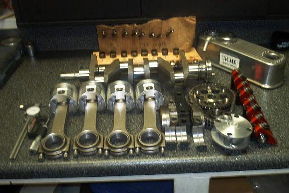

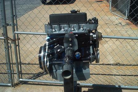

here's what I did this weekend.
Fardon Billet crankshaft
Carrillo rods
JE cutom pistons
Titan 1.5 roller rocker arms w/solid spacers
Comptune cylinder head
Comptune valves
Isky pushrods
Comptune/Isky oversized valve springs and alloy retainers
Fidanza aluminum flywheel w. Tilton OTII 7.25 racinf clutch
Kent vernier timing gear set
Comptune HL12 camshaft
MS lightened/hardened lifter
Superflow oil pump
Aluminum backing plate
Romac harmonic balancer
Oversized water pump pulley
Winners Circle super pan
etc., etc.,etc.
I just finished freshing this motor for the upcoming Mitty at Road Atlanta, thought you all would like to see all the goodies.

Hap:
Please warn us better first, my eyes were literally three inches from the monitor, by the time I got to the pictures.
My head subconciously just moved closer and closer as I read the list.
AWESOME.
Patrick
You're going to hide all of that cool
stuff INSIDE of the engine?I could stare at
artwork like that for hours.
- Doug

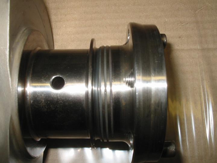

The other wild about this motor was the destroked crank slung a flywheel about 4 years ago and totly destroyed the entire flywheel hub on the crank, we had a company turn it down, add 4130 weld back and totally reconstruct the rear flywheel hub on the crank, can't even tell it was ever done, totally amazing work.
here's a few photos of the crank right after the rear hub was totally reconstructed.
