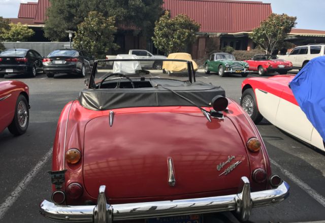

My wife drove behind me up to the Rendezvous in Bend and complained that I didn't use my turn signals during the day (I did). Healey tail/brake lights really aren't that bright during the day:

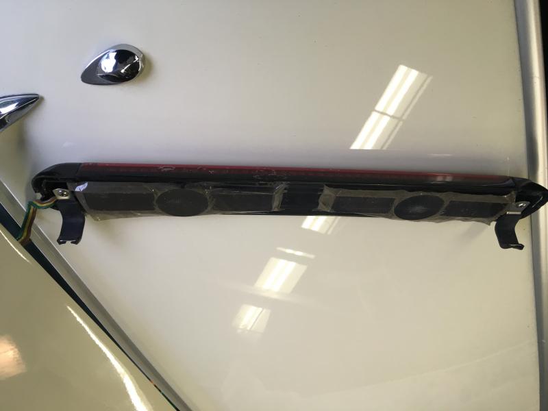

I'll try to load some photos for you. I've used two magnets and two rubber coated clips to hold the light in place. No drilling and no marking of the paint (so far after 8 years).

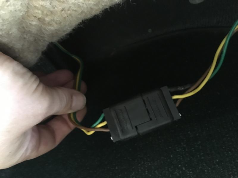

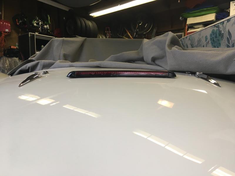

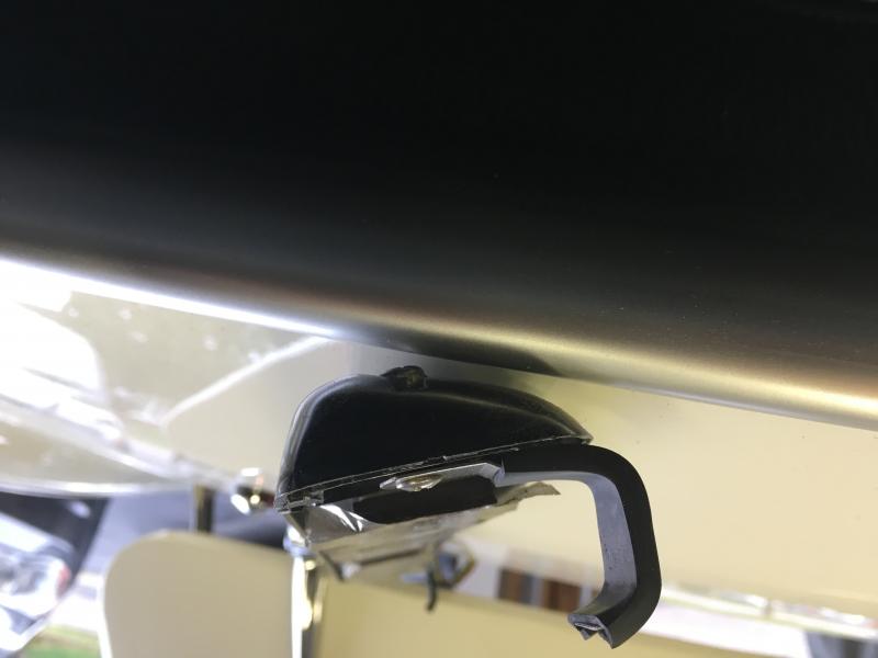

A few pics (I hope) of the third brake light. The two brackets fit into the boot lid opening to hold the light from moving. There are two magnets under the light as well.

Sorry for the delay and the lack of wiring pics (these pictures are upside-down on my screen by the way). I've not tried stronger magnets so I hesitate to comment but I think it could work. My wiring is basic trailer wiring that tucks into the tool tray behind the battery master switch and then runs down the bulkhead and under the Armorcord floor material. The electrical connection is by original bullet connector into the original harness on the driver's side (left hand drive car) which is again tucked under the Armorcord in the small "storage pocket". This is quick and easy and allows you to remove the wiring quickly for shows and takes advantage of the brake and turn signals. I'm going to create another one some day that allows the parking lights as well. That one is still in my head but I think it'll work with a resistor or two in the parking light circuit. If by chance you go that route let me know how it works.
