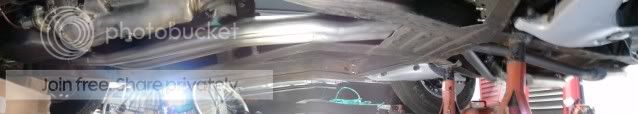

Here is a couple of my pics
Thru the T shirt
Wrapped that area
If you have the stock mufflers, ...have no idea.
If not... someone told me long ago to start at the back and work forward . Wrong (in my case) Start at the front and work back

Well after all the around and around of getting the right pipes and getting it situated.
The Exhaust is finally mounted and tightened.

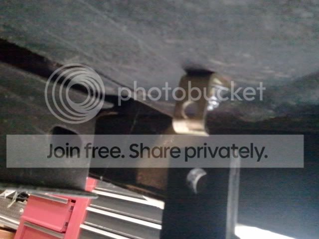

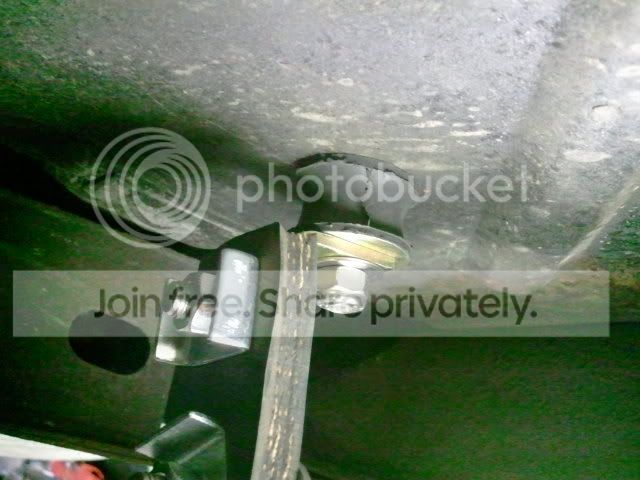

The only thing I did different was use this as my attachment which I think was different than most. I needed to drop it a bit as it was hitting the bumper on the pass.side
As long as it works for you, it looks just fine to me......
Will probably ,later, if I keep it a while shorten it up with a different bracket
