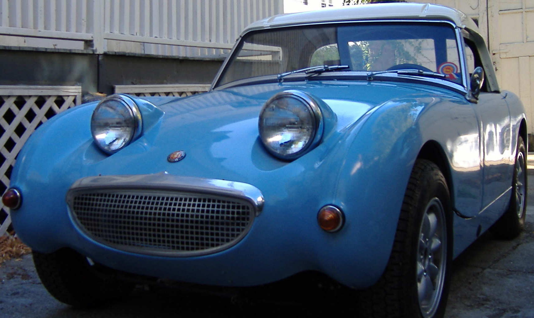

Here he is before the resto. After we get done with this phase, I am hoping to get a week off and do it myself. My brother is coming in tomorrow to help finish the engine assembly. I have posted some pics before of the progress.
The mods were front suspension lowering and camber, rear suspension lowering, panhard bar. Engine - head, carb, intake, offset rockers etc. from APT.
Interesting surprise was that the lower end had already been lightened hummm.

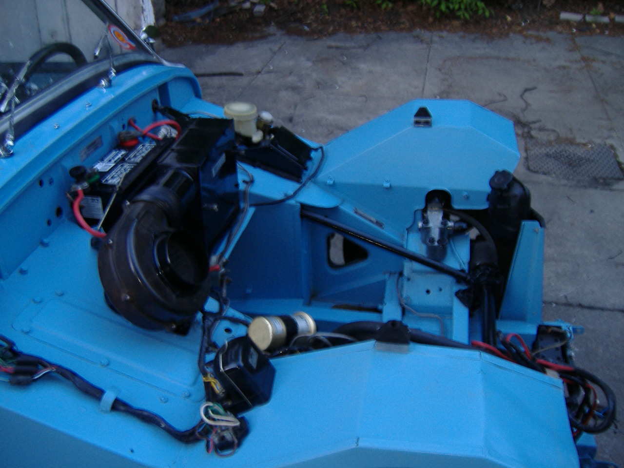

Here he is now - engine compartment shot. Waiting for the lil beast to enter.
Patrick

Nice 'n neat, Patrick. The hardtop and wheels are impressive too.
WOOO! That's BLUE!! What is is, MG Pageant Blue?
Thanks my friends!!!
The brake cover plate will be painted black (Jack's input)!
Tony, she was called Iris blue when colors had a name.
