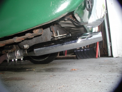

Thats the one I'm using on Bugsy my '68. I needed a couple of adapters to get to 1.5 or is it 1.75" pipe and tack welded the adapters. On mine there is a slot that a bolt with a washer on it would slide in but with the setup you've got a piece of flat bar stock and you can peruse some sort of universal hanger setup at local parts place. Here is a side view. Let me know if you need any other detail on how I did it. I'm working V.O. tomorrow and I can take other pics.
That's a piece of rubber strap / universal hanger BTW that bolts up through the floor of the trunk. And a piece of right angle bracket from the junk box I adapted to fit the track spacing on the muffler. You could do the same with an L shaped bracket bolted to those two screw fittings on that muffler and then attach to the rubber strap universal bracket. I did tack weld the adapters together as no matter how tight I made then they came loose. 5 minutes and $20 gets the same done at local muffler shop. And it does sound GOOD!!!!! Not like a Rice Rocket with a Fart Can attached to it.
Thanks for the pictures and ideas, guys. I've got a bit of planning to do tomorrow.
