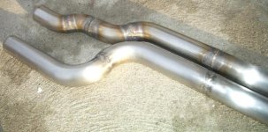

If you're talking about the Harbor Freight benders, they will kink the bends, I asked before I bought. The way I went was to buy J-bends and cut the shape I needed then weld it all together. A portion of my stainless exhaust.

greg, how are you? yes ive seen those pieces and would work great i guess im realy trying to justify spending the money on a tool that would take up even more valuable shop room but would potentialy add income, what ive learned about these benders is the same when it comes to tools in general "if you want a good one ya goddah spend dah bucks." ive also found that a good one of these benders is "big" bucks and id have to go into full time production in order to recoupe the investment, so ill do as you and roger abbott sug. and buy the bits and pieces and weld em up, thanks gregw, and roger abbott. :savewave: --- p.s. im now looking for a metal shear min 24" and brake about the same size , any sugs.?

I wish I could weld tubing as well as Greg. His work looks professional.
