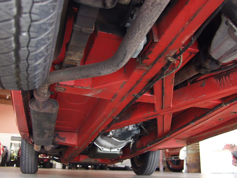

On a related topic, does anyone have a pattern for the original tail pipe plates that attach to the two rear mount points. They are kind of a pear shaped 1/8" thick plate with a hole in the middle for the pipe as can be seen behind the muffler on this car
