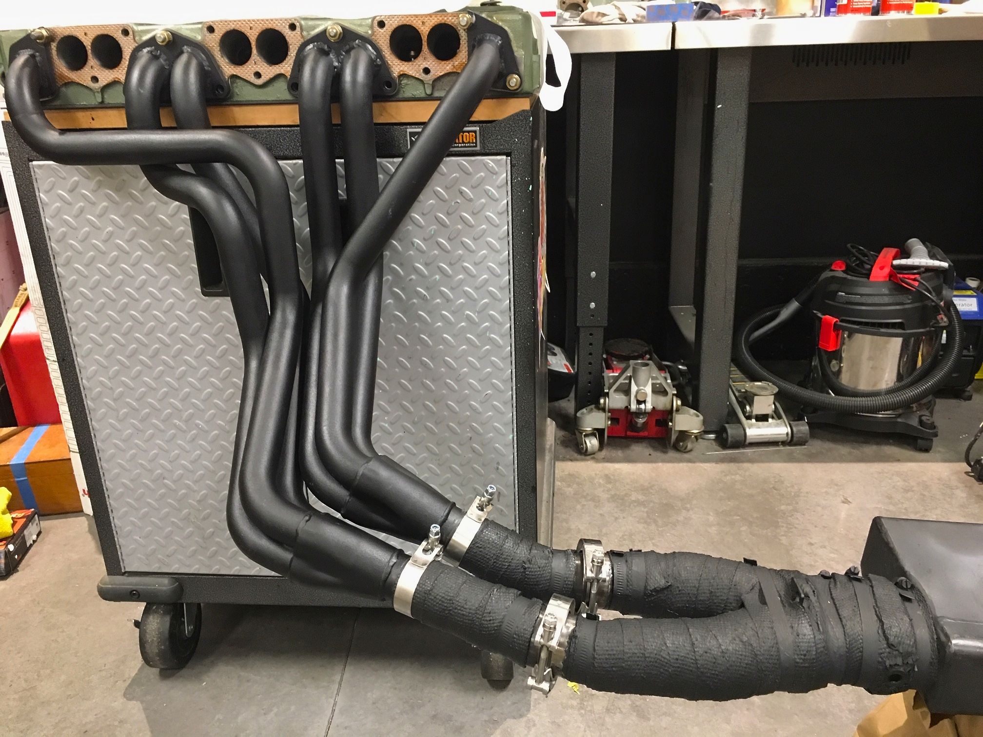

I have Kirk headers as in Randy's picture. I was concerned about coating thickness affecting the slip joint on the #1 tube. The jet-hot guy told me no problem - said the coating thickness is about like water.
I wondered about that slip joint. Is it suppose to slip?

I like Eastwood products and most of their paints work great with the exception of their hi-temp header coatings. They failed for me, but I run a pretty hot....Jet Hot is the only coating that has held up under race conditions. I went with the top shelf offering. > Heat Coating for Headers & Exhaust | Jet-Hot — Jet-Hot <
